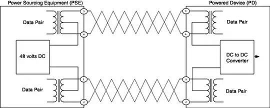

If you just ignore the POE 48 Volts in the image below, you can see Ethernet uses transformers on both sides.
This way there is no need for common ground as long as the common mode voltage stays below 1500V generally. The isolation specification of the transformers.
Imgur
And as a bonus you now also know how POE works. (802.3at)

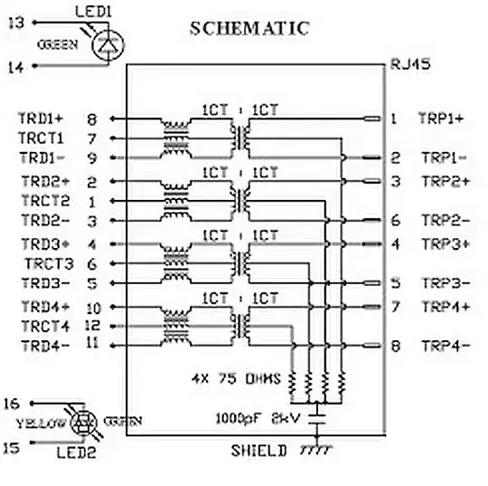

However, CAT6A often has a shielded connector. The shield is then grounded to chassis using the little flaps inside the socket.
Source image

    if anyone wants to see the correct schematic for the ethernet interface and how the shield ground in Cat5'or the PHY port is grounded and why ground is essential common and how it connects both CM and center tap to terminator resistance to ground with all differential signal terminated to ground the same and thus ground is critical to ethernet signal integrity but not as a single-ended pin on the jack but as a common mode R termination ground by RF cap to local ground. It is not done the way this PoE method is done, which would have horrible signal integrity unless short haul low bit rate. – Tony Stewart EE75 Jun 08 '17 at 02:29

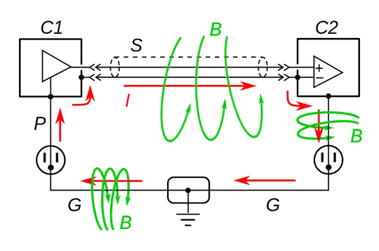

Why is Ethernet not grounded? There are two reasons:
  1. It would create a ground loop between devices
  2. The device would also be more susceptible to ESD which is prevalent in cables that are being moved or handled (from triboelectric charging of the cable)
The reason Ethernet is more susceptible to a ground loop is because:
  1. The loops could be much larger than other cable specs, with 100m between devices. USB is 5m, RS232 us 15m. Ethernet devices are more likely to be in different rooms, whereas USB devices are usually grounded to a computer (or hub) and are on the same ground or in the same room on the same mains circuit.
  2. The voltage of ethernet is lower ±1V with ~10mA of current. RS232 is much higher at 5V or 15V. USB is 3.3V. This makes it more susceptible to error.
The companies and engineers that designed the ethernet spec had this in mind (there is a lot of thought that goes into specs)
If you had a ground in between the transmitter and receiver it would create a ground loop. This ground loop would be formed by the cable and the return path would be mains ground as shown below. Any magnetic fields that flow through the loop would create a current along the cable (and the rest of the loop). Even if you isolated the signal wires this would be a problem because of mutual inductance between wires (wires run along side each other can couple currents from one to the other). This would inject noise (and cause potential bit error and packet loss).
So If you add an isolation transformer between devices, you break the loop and are still able to transmit a high speed signal between the transmitter and receiver. Another benefit of galvanic isolation, also increases the impedance of the cable to the device in the event of a large electrostatic discharge.
This is an example of isolation between two devices, ethernet has two isolation transformers, but the result is the same, it breaks the ground loop (and reduces common mode noise in conjunction with the twisted pair and common mode choke).
Images from wikipedia on ground loops

Ethernet also has no signals in the lower spectrum including DC because of the Bi-Phase encoding methods.
More important is that for signal integrity and EMI reduction for egress and ingress, the signals are transmission lines with 75 Ω termination and balanced with CM transformer and 1:1 centre tapped transformer. This raises the CM impedance on the user side for isolation while maintaining the differential impedance on the cable side to local ground in the upper spectrum where signals exist.
See the "ground connections" below
  • via 1000pF coupling cap and 75 Ohm terminators enter image description here
Tony Stewart EE75
  • 54
  • 185
  • CLEARLY , anyone that there is an AC ground for the Ethernet diff signals and without this it would fail as the CM noise levels of floating CM noise would be excessive even with CM choke with 100MHz~1GHz BW. Since the Terminators are AC grounded an earth ground is not needed, but there is a CM ground connection between connectors. So much for weak arguments of ground loops. These are not AC line loads currents! Why did everyone not understand this? (in the high scored answers). @laptop2d pls advise – Tony Stewart EE75 May 08 '17 at 06:14
  • ALthough OP asked about DC ground wire not included. It is not necessary since the current is shunted to AC ground via cap and thus the signals are in fact ground referenced at each end by definition Gnd = local 0V reference with low impedance to DC supply and AC ethernet common mode noise currents being shunted to local gnd to reduce EMI. and there is no need for AC line or DC shunting of noise as there is no signal here in lower spectrum. THis is critical to understand and not shown in any other answers. – Tony Stewart EE75 May 08 '17 at 18:50
    I fail to understand the ignorance of a person who (-1) but cannot articulate why – Tony Stewart EE75 Jun 10 '17 at 01:55
    I think you got a -1 because even with some basic electronics knowledge I had difficulty understanding your text. I would have LIKED to understand what it all means, because it looks like an interesting answer, but there seems to be some advanced EE concepts in there which is better suited for EE geeks and not for beginners or hobbyists. – Casper Jan 18 '18 at 02:38
  • The ground connection is clear on the schematic. Thats the answer. The reasons use common words for EMI.used by EE's in this field. – Tony Stewart EE75 Jan 18 '18 at 03:01
