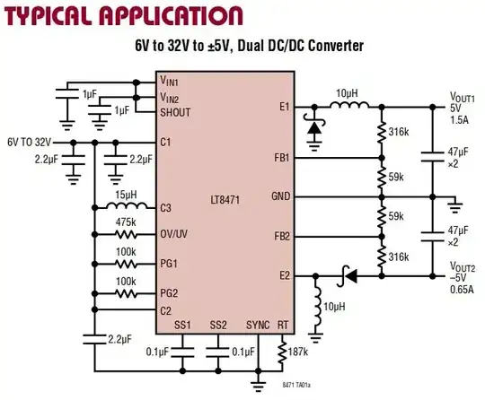

The design which caused issue is as below:
LT8471 based dual supply
My complete power budget is like below: - Input : 12V - Ouput Rail Load(mA) 5 1040 -5 544 2.5 800 -2.5 800 3.3 16
This kind of power supply distribution and design can be done with a bunch of switching regulators, but my question is how to completely eliminate the switching noise of DC-DC switching regulators.
In my previous design, I tried using output filter caps of 0.1F, 0.01uF, 47uF, 4.7uF as suggested, but it did not help me to the extent needed.
I am thinking of putting an linear regulator at the output of DCDC to reduce the noise. Is that proper solution, or should I use a pi filte? But they can create EMI issues to me (really not an expert in EMI avoidance. My senior suggested me to go for an inductor less module which helps in avoiding EMI issues.)
As my application is an electro-optic one, which involves analog opamps, I tried to have an output ripple voltage not more than few mV, so that it will not be difficult for me pick signals of low amplitudes around 30mV.

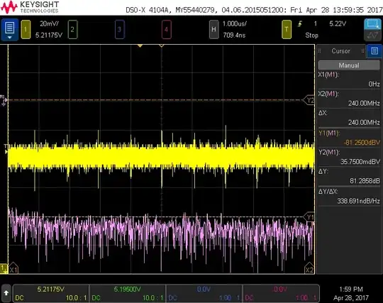

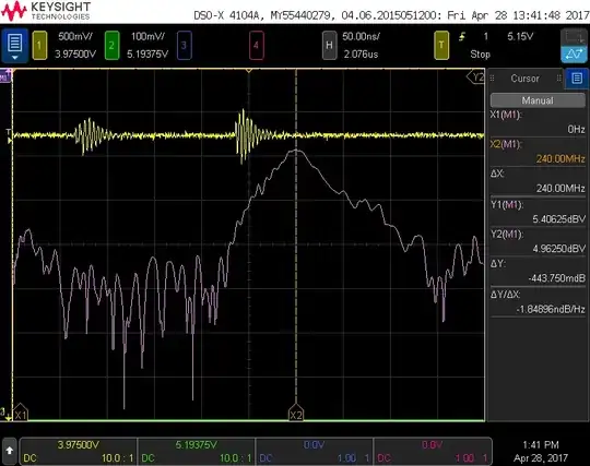

EDIT 1 : Addition of a CLC filter at DC-DC output:
Eith some suggestions of pi filters, I have tried to create a CLC filter using components at my desk.
L = 10uH and C being 4.7uF, 47uF, 0.1uF and 0.01uF(all 0603 SMD.)
I did not get a 1nF but I was able to see noise suppressed to an extent, this set up is bare soldered and checked whether filter output is proper or not, I did not solder this on actual board, instead I took +/-5V from board and checked the filter output.
Please find the images below
Without CLC filter:
With Out Filter
With filter:
With Filter
Please help me in reducing it much further. Will a common mode choke or adding a 1nF can help me more?
Will an output LDO reduce it much further?

    "my question how to completely eliminate the switching noise of dcdc switching regulators" - It's important to realize you can never completely eliminate it. You'll always have noise, even if you use linear regulators, or even batteries (which are actually noisier than specialty low-noise regulators). So the first step is to let go of the notion you can eliminate all noise. The second step is to quantify what noise is acceptable so you have a concrete design target. – marcelm Apr 27 '17 at 09:23
  • Not only is there output voltage noise, there's input reflected ripple currents, there's rail and ground conducted output noise current, caused largely by distributed capacitance. Creating a low-noise board with switching signals is almost a black art with loads of maths and also board layout consequences. No time to go through some of it in an answer, but rest assured it can be more complicated than just a filter in your schematic. – Asmyldof Apr 27 '17 at 09:26
  • It always matters where you route the filter caps, and that doesn't show up on a schematic. Identify the switches and hence the alternate current paths through the switcher, then minimise the area of the loop of current that has to be changed when the switch occurs. You do this by carefully selecting where you connect each high frequency capacitor to lines and ground. – Neil_UK Apr 27 '17 at 09:26
  • will isolated ground dcdc would solve my problem ?? – kakeh Apr 27 '17 at 10:15
  • results updated – kakeh Apr 28 '17 at 06:09
  • Return to https://electronics.stackexchange.com/questions/300498/eliminating-those-unwanted-op-amptia-outputs/302120#302120 and examine the PI filter I drew in my answer. NOTE I added inductance in the GND path. – analogsystemsrf Apr 28 '17 at 13:19
  • Why do you need to filter this noises ? I think the filter will only help for reducing conducted noise… Another point, when you modify the output filter, you modify the transfer function of your system and so the stability of your system… With an LC filter you have a second order filter whereas with a Pi filter you have a third order filter… You can have an idea of the stability of your system by doing step load. – Jess Feb 06 '20 at 07:31
