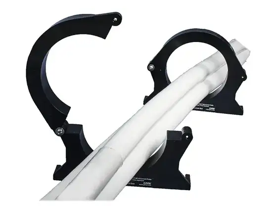

No, DC clamp probes have scales well above ±10,000A. Does no-one even check Amazon for their ±12000A DC to 40kHz current probe needs any more?
Clamp-on Current Probe I jest. But you can totally buy that on Amazon. And they have 10 in stock. None of them qualify for Amazon Prime though :(.
Whatever you do, ignore all these people telling you to use a shunt. No, do not use a shunt. There is absolutely no advantage to using a shunt in this application besides a very slight edge in measurement accuracy, and ridiculously huge downsides.

The reason most hand-held clamp meters only go up to maybe 2,000A is because much beyond that and the conductor would be too large or in a unusual shape (wide and flat bus bar, for example) that would require the clamp to be too large to go on anything portable of hand held.
But they certainly make clamp-on or loop current probes that have measurement ranges not only to 10,000A, but well above it as well. So just use one of those. They are high quality, safe, purely magnetic (operate on the Hall Effect), fully isolated and characterized, sensitivities on the order of 0.3mV/A.
Something like Clamp-on Current Probe (earlier linked to its page on Amazon).
And they have nice huge windows as large as 77mm to 150mm to fit your cabling. Unless you've gone with something more exotic... and chill.
Either way, I assume your cabling looks similar to one of the solutions in this picture:
Anyway, have fun. Be safe. Hopefully you're not a super villain.

  • Interesting. Have you actually used one of the CPCO ones? I have an aircraft application right now (maybe 500ADC for on board equipment), but a bit concerned about outside influence with return conductors nearby (which should almost always be true at high currents to reduce inductance) and no magnetic core used. The aircraft guys currently (?) use shunts. – Spehro Pefhany Apr 26 '17 at 12:40
  • 22
    Great answer but definitely +1 for "Hopefully you're not a super villain" xD – Kieran Apr 26 '17 at 13:47
    Nice answer. Don't forget to add a disclaimer just in case the OP blows up his home / lab / high school. – Enric Blanco Apr 26 '17 at 14:43
    According to Amazon, "Only 10 left in stock - order soon." Better get them before they're gone! – fool4jesus Apr 26 '17 at 16:37
    Does this also work for capacitor discharges on short time scales, as in the link in my edit above? – Julia Apr 26 '17 at 18:04
    Reading the specs http://gmw.com/electric_current/gmw/documents/Spec%20Sheet%20CPCO-12000-77-11JAN2016.pdf seems to tell me that the response time of 10 micro seconds should be enough because the time scale in my linked experiment is about 5 miliseconds for the discharge process. Is it correct that the device in your link just provides a voltage signal which I can measure using a voltmeter. So it should be possible to get the current -time curve using the leybold cassy system: https://www.leybold-shop.com/physics/physics-equipment-114/systems/cassy/basic-equipment/sensor-cassy-2-524013.html – Julia Apr 26 '17 at 18:23

  • DC to 40khz? How can it possibly work on DC, and super slow cycles would have to calibrate for inductance effects. – JDługosz Apr 28 '17 at 08:40
    @JDługosz It works on DC by using a Hall effect sensor. It measures the magnetic field directly instead of the more typical transformer-style arrangement. – Hearth Apr 28 '17 at 13:57

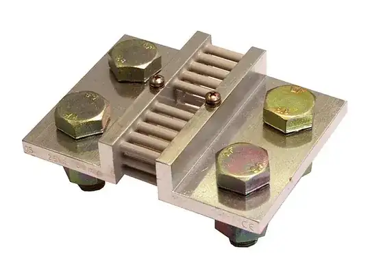

    Ouch! What a beefy component! Impressing! It doesn't even seem an electrical component, but some mechanical stuff! – LorenzoDonati4Ukraine-OnStrike Apr 26 '17 at 03:20
    Why does this have two screws on each side? Interesting. – chx Apr 26 '17 at 05:50
    @chx The two big bolts/nuts on each side are to connect to bus bars for the high current. The two little screws are for the wires to the meter. – Spehro Pefhany Apr 26 '17 at 06:27
    Very good contact between the shunt and the bus bars is necessary for such a high current. The contact area between both should be as large as possible. – Uwe Apr 26 '17 at 09:43
  • 20
    Are there SMD versions too? – Curd Apr 26 '17 at 09:43
    @Curd For that kind of current, you may need to use at least 2520 (1008) size. Are you willing to sacrifice the board real estate involved? – user Apr 26 '17 at 13:30
    In case anyone’s too lazy to look up the datasheet: That shunt is 310 mm wide, 170 mm high and uses M20 screws! For a current of 15kA. – Michael Apr 26 '17 at 17:48
  • The photo shows that it says 2.5 kA 60 mV right on the side. I doubt it would handle 6x as much current. –  Apr 26 '17 at 19:54
    @nocomprende It is not hard to imagine that other, larger shunts, besides the one arbitrarily chosen for an illustrative example photo, exist. – Jason C Apr 26 '17 at 21:22

Most other answers have assumed you want to measure 10KA continuously. However, your referenced use shows that it is only for a pulse of around 5 milliseconds. Because of this short time, the only way you can get a measurement is by using a storage scope to capture the waveform.
You also need a sensor connected to the 'scope. Whether it is a shunt or a clamp, is not very important, as long as it "matches" the 'scope being used.
Proper safety measures should be implemented and followed (as in the referenced experiment).

Regarding the general part of the question of how to measure extremly large currents, there are also devices called FOCS which use the faraday effect to determine the magnetic field of the wire and then calculate the current. For example ABB sells such devices for measuring up to 500 kA DC. See also: http://www.ee.co.za/wp-content/uploads/legacy/ABB%20Innovation%20in%20high%20DC.pdf
