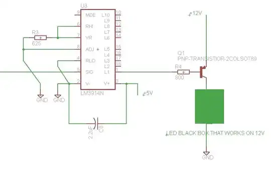

I am connecting the LM3915 to a PNP transistor to drive LEDs. I have it working in bar graph mode using one LED per output directly (no transistor).
On page 7 of the datasheet, it looks like pins 1,10-18 should put out a "0" when in the ON state. Connecting the PNP directly does not work. Measuring the output of the LM3915, I get about 4V, when OFF and 3V when ON. I'm measuring using both DVM and O-scope. I don't know how to drive the PNP with this output.

  • If you refer to the datasheet you could at least provide a link. – stevenvh Apr 17 '12 at 16:44
    And a schematic would be nice. How did you connect the 3915 to the PNP? – stevenvh Apr 17 '12 at 16:45
  • I added your schematic. Notice that the base of PNP will be about 12-0.7, or 11.3 volts. The datasheet recommends VLED ≤ V+, although it is an open-collector output, so it's not clear what badness happens when VLED > V+. – markrages Apr 18 '12 at 00:16

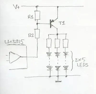

In this answer I explain how to drive a chain of LEDs from an LM3915, using PNP transistors. Is this what you want?

Tom, the LM3915 is a very efficient, effective, easy to use, simple log scale LED driver. Why do you want to add a bunch of PNP's with current limiting resitors and mess it up? Choose any color LED's you want with any brightness and viewing angle you want. Red/yellow tend are ~ 1.7V, Blue,green & white are ~ 3.2V diode drops so if using a 5V supply the open collector current source drivers will read 3.3V on red LEDs when on and then float up to 4V with just leakage current biasing the diode @ ~1.4V which is near the "knee" of the diode V-I curve.

  • I think he is trying to make it work with a commercial LED device that is intended to work from 12V. I don't know what else a "LED black box" could constitute. – Connor Wolf May 05 '12 at 08:21
  • Possibly the OPs ominous "LED black box" contains an array of LEDs with only one common cathode. This would prevent him from using the OC outputs directly. – Curd May 05 '12 at 08:41
    OP's schematic is the best solution if the LEDs need more than 30mA. – Federico Russo May 05 '12 at 08:58
