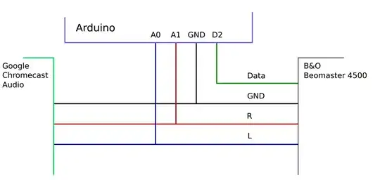

Below I have used a naive approach to connect an analog input of an Arduino to detect the sound.
Generally the project is working fine. But the problem is that the sound, especially the bass gets distorted/degraded when the Arduino is connected. How can this be avoided?
I have very limited experience in analog electronics and have no oscilloscope or any other equipment. My guess is that some/large amount of current must flow through the Arduino. Secondly, the Chromecast might deliver levels of voltage higher than 5v.

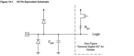

The distortion you hear is caused by the input protection diodes built in to IO pins of the microcontroller:
The diode to ground will turn on when the audio signal gets below zero, charging the DC blocking capacitors within the chromecast output and amplifier input and creating a local DC offset in the audio. When the audio signal then becomes positive, if the volume is great enough it will turn on the protection diode to the supply and discharge the DC blocking capacitors.
This effectively clips the peaks from the audio signal and places a relatively large load to the chromecast output, distorting the signal.

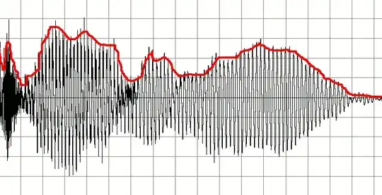

The arduino doesn't really need to receive the complete audio signal (black) to do the job you want it to. Knowing how high the peak amplitude (red) is would suffice. This is easily done with a simple circuit known as a envelope detector or peak detector.

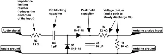

What you need to do is to add a capacitor to AC couple the audio, add a peak detector to easily detect the presence of an audio signal, and add a voltage divider to guarantee a safe input level to the arduino.
schematic
Be aware that this circuit won't work for audio signals below roughly 1.4 V peak to peak. If your signal is weaker than that, you can either:

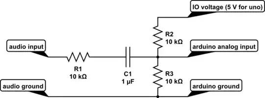

  • Condition the unmodified (no peak detection) signal for the arduino ADC and do all required processing in software:
schematic
simulate this circuit
This circuit attenuates the amplitude to one third and biases the signal to 2.5 V, so that signals below 15 V pk-pk are always within the input range of the ADC.

  • The last circuit is the best option in my opinion, I would just increase all the resistors a bit, I think the ccast expects a load impedance in the 10k range so the 3k3 you are adding are a bit too much. – Vladimir Cravero Apr 17 '17 at 20:38
  • @VladimirCravero Neglecting the complex impedance of C1 and the (quite high) impedance of the arduino ADC itself, the last schematic has an AC impedance of 10k + 1/(1/10k + 1/10k) = 15k from the audio input side. Not 3.3k. Also, the chromecast audio can drive headphones, so 15k extra impedance isn't an issue. – jms Apr 17 '17 at 20:54
  • yep it is 15k, sorry. I thought the cc was supposed to be connected to a line in, if it's made for headphones even 100 ohm is not an issue – Vladimir Cravero Apr 17 '17 at 20:56
  • "This circuit attenuates the amplitude to one third and biases the signal to 2.5 V, so that signals below 15 V pk-pk are always within the input range of the ADC." Should't that be 5 V pk-pk, instead of 15? – empewoow Jun 10 '23 at 17:11
  • @empewoow it depends on which node of the circuit you’re talking about: Yes, the analog input pin of the arduino should stay between 0 and 5 volts (5 V pk-pk). Due to the 1:3 voltage divider, the input to the signal conditioning circuit can be up to 15 V pk-pk without clipping – jms Jun 12 '23 at 10:19
