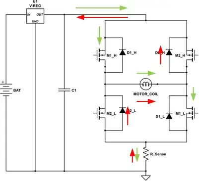

CLASSIC FLY-BACK
Classically, we see the following circuit used where fly-back diodes across the bridge switches allow the drive current, shown in green, to be rechanneled back to the power supply (shown in red).
However, I have always had grave concerns about that method, specifically about how that sudden reversal in current in the supply line affects the voltage regulator and the voltage across C1.

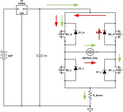

RECIRCULATION FLY-BACK
An alternative to classic is to use recirculated fly-back. This method only turns off one of the switch pairs (low or high). In this case the red current only circulates within the bridge and dissipates in the diode and mosfet.
Obviously, this method removes the issues with the power supply, however it does require a more complex control system.
Current decay is much slower with this method since the voltage applied across the coil is just diode-drop + IR of the on mosfet. As such, it is a MUCH better solution over the classic method while using PWM to regulate the current in the coil. However, for snuffing the current before flipping direction, it is slow, and dumps all the energy in the coil as heat in the diode and mosfet.

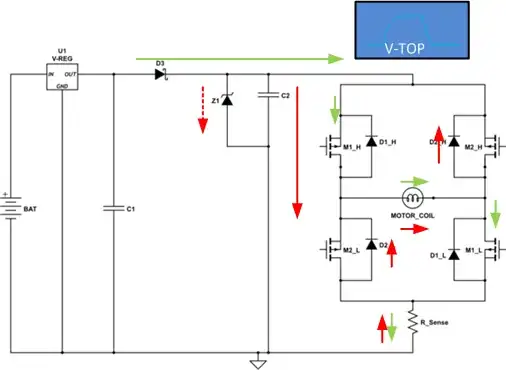

ZENER BYPASS
I have also seen the classic fly-back method modified to isolate the supply and use a Zener bypass as shown here. The Zener is chosen to be a significantly higher voltage than the supply rail but a safety margin less than whatever the maximum bridge voltage is. When the bridge is closed the fly-back voltage is limited to that zener voltage and the recirculation current is blocked from returning to the supply by D1.
This method removes the issues with the power supply, and does NOT require a more complex control system. It snuffs out the current faster since it applies a larger back voltage across the coil. Unfortunately, it suffers from the issue that almost all of the coil energy is dumped as heat in the Zener. The latter therefore has to be rather high wattage. Since, the current is terminated more quickly, this method is undesireable for PWM current control.
ENERGY RECYCLING ZENER BYPASS
I have had considerable success with this method.
This method modifies the classic fly-back method to isolate the supply again using D3, however, instead of just using a Zener, a large capacitor is added. The Zener now only plays the role of preventing the voltage on the capacitor from exceeding the rated voltage on the bridge.
When the bridge closes the fly-back current is used to add charge to the capacitor which is normally charged to the power supply level. As the capacitor charges up past the rail voltage, the current decays in the coil and the voltage on the capacitor can only reach a predictable level. When designed correctly, the Zener should never actually turn on, or only turn on when the current is at a low level.
The rise in voltage on the capacitor snuffs out the coil current faster.
When the current stops flowing the charge, and energy that was in the coil, is trapped on the capacitor.
Next time the bridge is switched on there will be a larger than rail voltage across it. This has the effect of charging the coil faster and re-applying that stored energy back into the coil.
I used this circuit on a stepper motor controller I designed once and found that it significantly improved the torque at high step rates and in fact allowed me to drive the motor considerably faster.
This method removes the issues with the power supply, does NOT require a more complex control system, and does not dump much energy as heat.
It probably is still is not suitable for PWM current control though.

For PWM-driven DC motors (with frequencies in kHz range and up), we have to deal with the back-EMF of the coil, and recirculated fly-back is the most sensible option. The whole idea is to keep the current through the coil constant, and low resistance of open MOSFETs helps a lot.
BTW, you'd want to keep both upper MOSFETs open, since an open MOSFET has much lower voltage drop as a diode. Relying on flyback diodes results in significant losses and Zener/resistive bypasses only make it worse.
For constant-current motor control signals (with much lower frequencies), the most important factor we have to deal with is the back-EMF of the motor which starts to act as a generator driven by its own inertia. In this case, providing a low-resistance path for the generated current means you're actively braking the motor. If that's what you want, you could keep using the recirculated fly-back up to a certain limit, since the kinetic energy is dissipated by your MOSFETs and flyback diodes. Past this limit you'd have to use a ballast resistor to dump the heat into.
If you don't want to actively brake, you'd typically use a zener bypass. It should be noted that except special cases (like an electric car going downhill, where friction is dwarfed by incoming mechanical energy), a DC motor cannot generate higher voltage that it was just driven with. So the zener is typically only needed to absorb the back-EMF of the coil, and then it's not supposed to conduct anymore. It only absorbs coil energy, not the kinetic energy of the motor (which MOSFETs would also have to absorb in case of recirculated fly-back).
Zener + capacitor is a nice idea, but only when your MOSFETs are rated to a significantly higher voltage than the rail voltage, and you can afford driving your motor with a voltage you don't control precisely.
