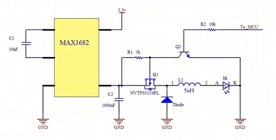

10
This is the most efficient way I can think to do it. There's a MAX1682 charge pump to give you 6.6v at the super capacitor. The voltage doubler is pretty efficient, probably more then 90%, but they can't supply huge currents. But what's the average current?
5A * 100us / 10s = 0.05mA.
That's well within the MAX1682's 45mA spec.
From a brief look at the datasheet, I couldn't see any reason it wouldn't work with such a large capacitor for C2.
Thanks to Russell McMahon for advice about charge pump efficiency. It looks like an inductor based solution would be more efficient, but would require more components. Take a look at something like MAX17067. This also has the benefit that it can produce the higher voltage required by three LEDs in series. I'll add it to the schematic tonight.
Flash 1
Now the important bit. You'll notice that there's no current limiting resistor. The current limiting will be performed dangerous open-loop style by the MCU. You'll have to get this right by calculation or trial and error (or both).
By supplying PWM to Q2's gate, you will be able to use the inductor as an efficient current limiter. But you won't get a very reliable current this way. It may not matter hugely, as long as 1) sufficient power is delivered to the led in 100us, and 2) the LED's current limit is not breached.
Here's a simulation I did in Altium. I used a 5uH inductor (not the 10mH shown in the schematic). And I supplied PWM with 12us on time, and 3us off time to the gate. I didn't use the 100uF capacitor, just a fixed voltage source instead. So you could expect some current droop.
Current control with inductor and PWM
Red is the current in amps, and blue is the PWM signal. You can see that you get close to 5A within 20us, and stay pretty close to it after that.

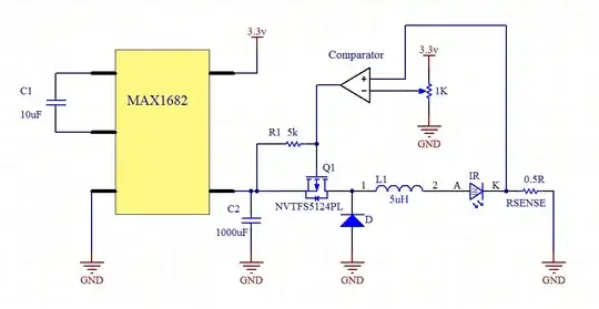

If you want better current regulation, then you can add a sense resistor, and use it to feed back to the MOSFET.
Flash 2
Here we have a 0.5ohm current sense resistor. At 5A, this should give us 2.5v to the comparator negative input. This is compared against the value from the pot. If the current is too high, the comparator switches off, and vice versa. The switching speed will vary depending on the hysteresis of the comparator. If the speed is too high, then you can increase the hysteresis (and decrease the switching speed) by adding a few hundred k resistor between the comparator output and its + input.
Note: You must use a high speed (<0.1us propagation delay) comparator with open drain output. You might look at the LMV7235 which is available from Farnell for about one pound.

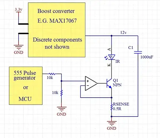

Added:
OP has stated:
  • He wants a very fast rise time on the current
  • Not interested in efficiency
  • There will be a single pulse, or two pulses 80us apart, then a long pause
  • Wants a simple, robust circuit
Here is a circuit which is a linear current regulator. This is only feasible because the duty cycle is very low. This circuit will likely over-heat the transistor if the duty cycle is too large.
Flash 3
Thoughts:
  • A high voltage from the MCU or 555 will switch on the LED. A low voltage will switch it off.
  • Set the current using the voltage divider, or put in a pot so that it's adjustable. Or use a digital pot or DAC so the MCU can vary it.
  • In the schematic, the current is set to 3.3A. You can set it to whatever you want.
  • I drew only one LED, but it's meant to represent three LEDs.
  • If you use only a single LED, then set the boost regulator's output voltage lower accordingly.
  • I suggest a 555 based pulse generator for safety reasons, so it would be fairly hard to leave the current on
  • You could also make it safer by choosing a boost regulator which has a current limit. So, even if the flash is left switched on, the regulator would just limit the current anyway.
  • I cannot say what the switch on time will be. This will depend on the inductance of your wiring.
  • You should lay out the PCB carefully to avoid EMI.

  • Be careful, the Q1 you drew has its source on the left (connected to C2). Real-world silicon MOSFETs have a parasitic diode that goes from S to D, so Q1 will always conduct. Even if you flip it horizontally, it will be difficult to turn it on, because none of S and D are ground. There are other issues, too. Too late here. I'll comment tomorrow. – Telaclavo Apr 23 '12 at 00:07
  • @Telaclavo - I have updated the schematics. I hope they are correct now. Please let me know what you think. – Rocketmagnet Apr 23 '12 at 09:12

    @Rocketmagnet how about this Exar (http://www.exar.com/power/led-lighting/regulators/step-up-down-regulators/xrp6840/) solution with super cap? Unfortunately, the solution cannot time the pulses but perhaps that can be done with the external mosfet and secondary control mechanism. All I am proposing is inserting mosfets before the LEDs and control those mosfets based on the pulse timing. – Ktc Apr 25 '12 at 11:21
  • That solution cannot provide enough power. It's only 1.45A per LED. You wanted 5A per LED. – Rocketmagnet Apr 25 '12 at 11:47
  • @Rocketmagnet there is a version (1 channel I think) that can pump 4.5A. Assuming I can get 5.6V output, I can put two LED in series. The issue is starting and stopping it. This ic is designed in a way that you cannot stop the light. – Ktc Apr 25 '12 at 14:10
  • @Ktc - But you said you needed 5A. I am now confused about the spec. What is the actual tolerance on the current. If you can accept only 4.5A, why can't you accept a lower rise time? – Rocketmagnet Apr 25 '12 at 14:16
  • @Rocketmagnet I am not as precise you are right, 4.5A would mean lower light output, not preferred but a compromise that one could accept if the solution is robust. – Ktc Apr 26 '12 at 01:28
  • @Rocketmagnet Thanks.. You asked for feedback. I tried to simulate the circuit above without good success. However I understand the circuit, the opamp and the constant current nature of the diagram. Could you please elaborate what you mean by wiring? These are SMT LEDs. – Ktc Apr 27 '12 at 05:57
  • @Rocketmagnet I build this today on the breadboard. The circuit is extremely sensitive to the voltage on the IN+. If I touch with my hand to IN+, LED turns on. Truth is I couldn't manage to turn it off when uP is connected. Pulsing a high current turned out to be difficult. I used MCP6021 as the opamp. VN10LP from Diodes as the mosfet (I had that around, didn't use BJT). 1 ohm as RSense and the LED in question. Couldn't get it to pulse the way I wanted. (I see the pulse in IN+ but not from LED, I tried various pulse sizes, no luck) Need to look at it but it seems circuit needs more work. – Ktc Apr 27 '12 at 11:16
  • @Rocketmagnet also, if I short IN- to 5V, I see a super bright pulse. Somehow, either opamp selection or mosfet selection was not optimum is my guess. I will spend more time on monday to choose better components, perhaps try with BJT as well. – Ktc Apr 27 '12 at 11:18
  • @Ktc - I say wiring because I know next to nothing about the application. There must be some copper from the LEDs to the rest of the circuit, even if it's a PCB track. You will need to take care that this doesn't cause EMI. – Rocketmagnet Apr 27 '12 at 11:31
  • @Ktc - Are you currently using a FET? The circuit recommends a BJT. – Rocketmagnet Apr 27 '12 at 11:32
  • @Rocketmagnet this is essentially a constant current circuit. I think there is no difference between BJT and Mosfet. Either case they act as a variable resistors. – Ktc Apr 27 '12 at 11:35
    @Ktc - The only thing is, with a FET, there are many more ways to choose the wrong one. A BJT really only needs to be NPN. Of course, the even simpler way to do this is just with a current limiting resistor. But then it might be a bit too sensitive to variation in LED forward voltage drop. – Rocketmagnet Apr 27 '12 at 11:51
