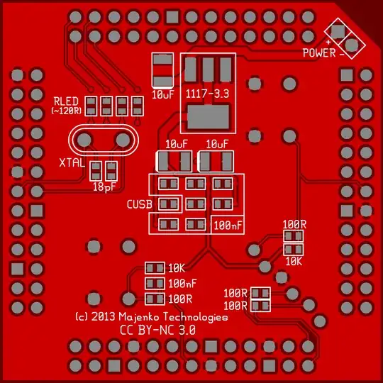

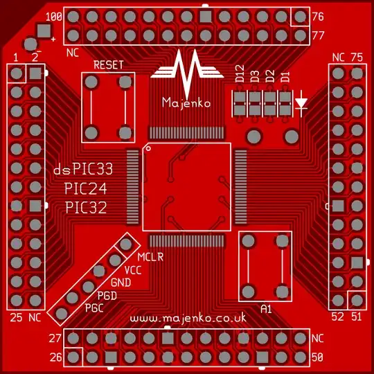

I designed an almost identical board a number of years ago. There's a number of things I really don't like with that old design (such as the crystal traces) so please don't critique it.
I had a 100nF capacitor on each Vdd pin plus one single 10µF for the whole chip (plus of course one for Vcap). All my capacitors were directly under the chip on the reverse side, and I used all MLCC, although the footprints I chose for the 10µF capacitors would accommodate a tantalum if wanted.
As you can see the power traces just go straight under the chip to then pass through direct to the 100nF capacitors. Those capacitors are then fed direct from the 10µF reservoir capacitor.

  • Close decoupling under chip looks best in this design but ground/supply ripple margin can be improved further with isolated tracks paths to each side of chip for Vcc,Vee (star ground 4 sides of chip) Even when everything works, margin is unknown unless tested at low voltage or worst case loads with 48MHz clock. Probably ok for function but EMI not sure. – Tony Stewart EE75 Mar 30 '17 at 15:29
  • Vdd, Vss you mean -- it's CMOS, not TTL :P – Majenko Mar 30 '17 at 17:08
  • But yeah, the grounding is one of the things I am not happy with. These days I have it so the pad under the chip is directly connected to the ground pins to form a local low impedance ground - plus I usually use QFN when possible, and that has an exposed ground pad underneath the chip too. I can't believe that was 4 years ago now that I made that board... I still occasionally get people asking if I still make them - maybe I should take the time to create a revised version... – Majenko Mar 30 '17 at 17:11
