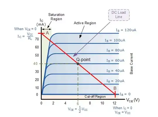

As user Finbarr said, it's all about defining the working region, not the amplification ratio. With wrong R1, R2 setting you go in saturation or non-conducting region.
Source : http://www.electronics-tutorials.ws/transistor/tran_2.html
Calculated example:
enter image description here enter image description here enter image description here
