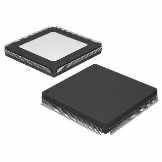

David already said that there are also QFPs with thermal pads, like this PQFP-208:

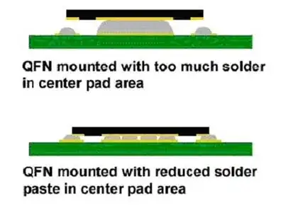

On some devices it helps cooling the device, though you'll have to take additional actions. You'll need a lot of filled vias to transfer the heat to an inner ground plane. Also, most manufacturers recommend not to use a full central pad, since too much solder may lift the IC so that pins at the edge may not make contact with the solder paste.
Instead a patterned stencil is suggested, like this:
or
Note that this is just for the stencil, not the pad.
