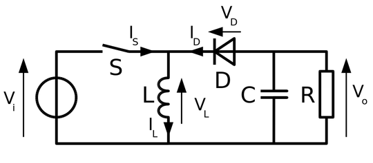

There are multiple ways you can achieve 12V regulation:
  1. Buck-Boost Converter
  2. LDO (Voltage Regulators)
  3. Voltage divider (That is never used... Very inefficient)
Let's focus on the buck-boost converter since this is probably the best way to supply 12V continuously over a range of time. A buck converter will convert high input voltages to a fix output voltage whereas a boost converter will convert low input voltages to a fix output voltage. A buck-boost converter is a combination of both converters described in the past couple sentences.
As you can see in the circuit above, there is a switch controlled by PWM that will control the voltage on the load. Here is how the current will flow depending whether or not the switch is open or close in the circuit.
Note that the 12V can also be regulated using a LDO. In this case, it can be useful since there is not a major voltage drop across Vin and Vout. Therefore, the power dissipation through the LDO is much less. Sometimes, dropping the voltage from 12V to 5V, care must be taken since the LDO may overheat and destroy itself.
