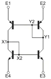

I am trying to figure out how to use a Zetex ZDS1009 IC. The chip contains 2 PNP and 2 NPN BJTs set up for current mirroring. I have learned about current mirrors, but I have not seen a 4 BJT mirror.
I have another chip that outputs a current, but it is weak and I would like to isolate it from the load. Any recommendations on how to hook up the ZDC1009 to take the current input and mirror it?

That's really a dual current mirror hooked up in a balancing circuit. The application circuit makes more sense than the four transistors by themselves:
What's going on here? Transistors 2 and 4 are really just diode-connected; transistors 1 and 2 form one current mirror, and 3 and 4 form another.
The causality chain (not that there really is one in electronics, it's more of a constraint system) is something like the following (Qn = transistor n, Icn = collector current in transistor n):
  • current through R2 lowers the voltage on Q2's base.
  • This pulls Q1's base down and sources current out Q1's collector so that Ic1 * R1 is approximately equal to I * R2. (in general transistors Q1 and Q2 will have a slight mismatch and they won't be exactly equal)
  • This flows through Q4 and into R4, producing an output voltage = I*R2/R1*R4, as explained.
  • It also pulls the base of Q3 up, so that current through Q3 is approximately the same as Ic4 * R4/R3 which approximately = Ic4 if you use the same resistor values for R3 and R4.
  • This current flows through Q2, so that Ic2 approximately = Ic1.
  • By making the currents through Q1 and Q2 approximately the same, this compensates for transistor mismatch, and the part is specified to produce a gain variation of less than 1% with an offset voltage of less than 4mV.

  • Yes I need a unidirectional current flow, and the voltage will vary but in need the current to be stable. Thank you for breaking that chip down for me. I was hoping for a current mirror chip but I might just get a chip that has uncomitted BJTs. – Z2012 Apr 10 '12 at 15:54
  • Nobody really sells matched BJTs anymore for an affordable price, even though they're a basic building block build into most bipolar opamps. It's sad.
    But if you have emitter resistors, the sensitivity on transistor matching is greatly reduced, at the cost of decreased dynamic range.
    – Jason S Apr 10 '12 at 16:02
