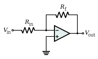

If these requirements aren't met several basic opamp circuits wouldn't work. Take for instance the inverting amplifier.
The transfer function is
\$ \mathrm{V_{OUT} = - \dfrac{R_f}{R_{IN}} \cdot V_{IN}} \$
as derived in this answer. The proof relies on the infinite input impedance, but you can't explain the transfer function based on both inputs equal, because that's not a property of the opamp! So-called proofs that start from the fact that the inverting input is at ground are invalid.

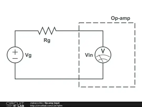

The answers are all good, but there is a more basic and more important concept behind that, in part explained by David.
The Op-amp, at least the most common type of op-amp, is a voltage-input, voltage-output component: it means that it takes a voltage as input, does some operation and spits out another voltage.
Reading a voltage requires attaching an instrument to the voltage source, as you would do with a voltmeter: this instrument has to be put in parallel (has to read the same voltage) with the source itself, and will see a current on it that depends on the input resistance of the instrument itself, in this case the op-amp. The current will also flow on the output resistance of the source, as shown in the picture:
The current on the resistor will cause a drop on the input voltage to the op-amp, that won't be anymore equal to the source: we don't want that.
So if the op-amp has an infinite resistance, the current on the input will be zero and the read voltage will be Vg, as desired. Of course that's an ideal condition, but the higher the better.
