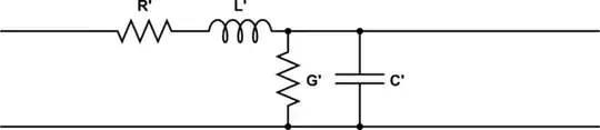

Say we take a typical transmission line model, with inductance, capacitance, resistance, and conductance distributed throughout the line:
schematic
The characteristic impedance is:
$$ Z_{0}=\sqrt {R+j\omega L \over G+j\omega C} $$
So wouldn't that mean if we expect to have a transmission line with a real characteristic impedance, it must be that \$R/G = L/C\$?
So then I wonder, do non-real characteristic impedance transmission lines exist? Are they typical? What does it even mean to have a non-real characteristic impedance?
If no, my understanding is G represents the conductivity of the dielectric, while R represents the resistivity of the conductor. Each being lossy non-ideal properties I'd guess the goal is to minimize them, but if hope to achieve a real Z0 this means carefully matching the non-ideal properties of both the conductor and the dielectric, ideally in a way which holds over a wide range of frequencies. Sounds difficult.
Or is it that R and G don't directly correlate to physical quantities, and they are just values mathematically selected to fit the equations to the behavior of the circuit?
Yes.
An ideal transmission line has R = 0 and G = 0. This gives a real characteristic impedance. But this is an idealization. These numbers are never actually 0 in reality, so the imaginary part of characteristic impedance is never truly 0.
It means the transmission line is lossy. The sum of output power and reflected power will be (at least slightly) less than the input power.
This isn't practical.
More often you just try to get R and G low enough that they can be ignored for practical purposes.
Minimizing G means choosing a dielectric material appropriate for the frequencies you're using.
Minimizing R means using a larger conductor (wider trace on a PCB or larger diameter coax). But this also tends to decrease the maximum frequency before the transmission line goes multi-mode. End result: at high frequencies, you just have to use small geometries and deal with the loss.
Due to skin effect, R tends to increase in proportion to \$\sqrt{f}\$, and this will typically dominate the frequency-dependent loss of a transmission line, if the dielectric has been chosen appropriately for the operating frequency band.
R is pretty directly tied to the conductivity of the conductor material. Skin effect also plays an important role. This is why you see silver-plated conductors on coax meant for high frequencies.
G relates to the polarization behavior of the dielectric, so it's harder to tie down to a specific physical mechanism. Generally if you're choosing dielectrics for high frequency designs, you'll see the loss specified as a loss tangent, but it will probably only be specified at a single frequency, which naturally won't be the one you're designing for.
Yes, all transmission lines in the audio range have a complex impedance. Given that R and jwC dominate at "mid audio", the impedance of any regular transmission line becomes \$\sqrt{R/jwC}\$. Note that the suare root of 1/j is equivalent to a phase shift of 45 degrees.
This is why telephone systems model their line impedance with a "complex impedance" rather than using the earlier 600 ohm "fits all" standard: -
As frequency rises above audio, jwL starts to dominate over R and your get the more familiar \$\sqrt{L/C}\$ version. This happens anywhere from about 100 kHz to over 1 MHz.
Conductance doesn't play any role in a sensibly designed cable until dielectric losses become significant i.e. At high frequencies.
