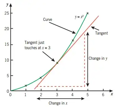

If you had a curve of \$y = x^2\$ like below: -
The slope at when x = 3 (y = 9) can be estimated by calculating how much y changes divided by how much x changes. The change is called "delta" hence the slope is \$\Delta y/\Delta x\$.
Taken to infinitesimal changes, mathematically it gets "renamed" to dy/dx. It can even be algebraically proven by adding dy and dx to the original formula: -

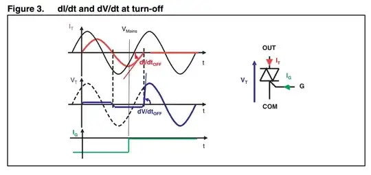

So far everyone has explained what \$\frac{\Delta v}{\Delta t}\$ means ( rate of change of voltage, its gradient, the 1st derivative of a voltage w.r.t. time )
But what does this have todo with TRIAC's? Triacs, like Thyristors/SCR's can be re-gated if there is high dv/dt across the device
http://class.ece.iastate.edu/ee330/miscHandouts/AN_GOLDEN_RULES.pdf
This is most likely to occur when driving a highly reactive load where there is substantial phase shift between the load voltage and current waveforms. When the triac commutates as the load current passes through zero, the voltage will not be zero because of the phase shift (see Fig. 6). The triac is then suddenly required to block this voltage. The resulting rate of change of commutating voltage can force the triac back into conduction if it exceeds the permitted dVCOM/dt. This is because the mobile charge carriers have not been given time to clear the junction.

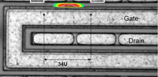

The charge injection of dV/dT also puts FETs at risk. Unless sufficient Source contacts and Well contacts are in place, the charges will pursue ALL POSSIBLE PATHS; current crowding into contacts may cause I*R drops large enough to turn on emitter-base junctions of parasitic bipolars, in which case the bipolar adds to the current flows. In many cases, that brings about Gain > 1 positive feedback, and the FET/bipolar try to discharge the entire VDD charge storage network down to ZERO VOLTS. With that mere attempt, silicon and aluminum melt.
How to avoid? Design the Source and Well contacts for transient charge tasks, not just for DC leakage control.
Here is microphotograph of high voltage under transient conditions (1volt per nanosecond) injecting charge, with that charge then crowding around a Well Contact.
