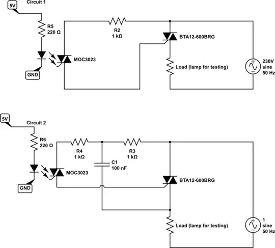

I've tried with two circuits.
schematic

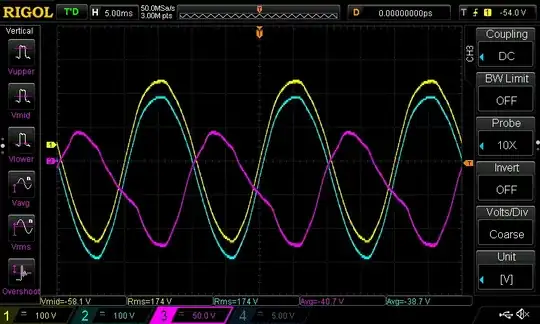

The oscilloscope is showing:
Channel 1: Mains voltage (via 10k resistor)
Channel 2: TRIAC gate voltage
Channel 3: Load voltage
I'm assuming that the gate voltage is following the mains voltage, because the TRIAC driver is conducting.
Is the resistor values too high and there's not enough current through the TRIAC (BTA12)?
Why does channel 3 look so weird? Is it because the TRIAC is conducting partially? It seems to be ranging from +50V to -125V.
I'm aware that an inductive load may cause the circuit not to turn off properly, and that I might have to have a snubber circuit (like in circuit 2) to ensure correct turn off. But I was thinking to introduce that later.
Reference circuits
I've drawn inspiration from these circuits I found online. They seem to use resistors ranging from 100 ohm to 3k ohm. Since I wanted a low standby power consumption, I chose 1k (which is further limited by the 100nF capacitor).

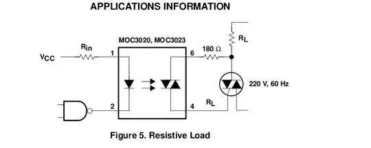

Um..it looks to me like the MOC is not turning on... since there is no R load circuit path. According to the MOC spec it should look like this....
The load is on the other side of the gate on that too...
Also be aware, driving an inductive load with an SCR is a bit different from a resistive load.

  • Okay, I can try to solder one on. Any suggestions about correct values for the three resistors? It's a bit of a pain to change them. – user95482301 Mar 12 '17 at 03:30
    UNfoortunately it did not say. The gate load being on the wrong side may also be an issue though. Vgt will change if u can get it to switch – Trevor_G Mar 12 '17 at 03:34
    So it makes a difference whether the load is attached to A1 or A2? I thought the TRIAC was bi-directional. – user95482301 Mar 12 '17 at 03:37
  • Picks Rs to get 0.8 < Vgt < 1.3V – Trevor_G Mar 12 '17 at 03:38
  • Is is bidirectional, but Vgt needs to be referenced to AC minus. Or at least that's how I understand it and have always seen it. That other schematic you showed may prove otherwise. – Trevor_G Mar 12 '17 at 03:39
    @trevor. It is incorrect that you need the resistor you point out. It is there only to provide a leakage path just in case you are driving a Sensitive Gate Triac. – Jack Creasey Mar 12 '17 at 04:49
  • @JackCreasey, thank's Jack.. good to know. What's your opinion of which side the load should be on? – Trevor_G Mar 12 '17 at 14:34
    @Trevor. It is conventionally as shown above, but it technical makes no difference. An RC low pass filter does not know which side is signal and neutral on a floating AC pair. – Jack Creasey Mar 12 '17 at 16:13
Connect the load on the hot side like resistive load.
