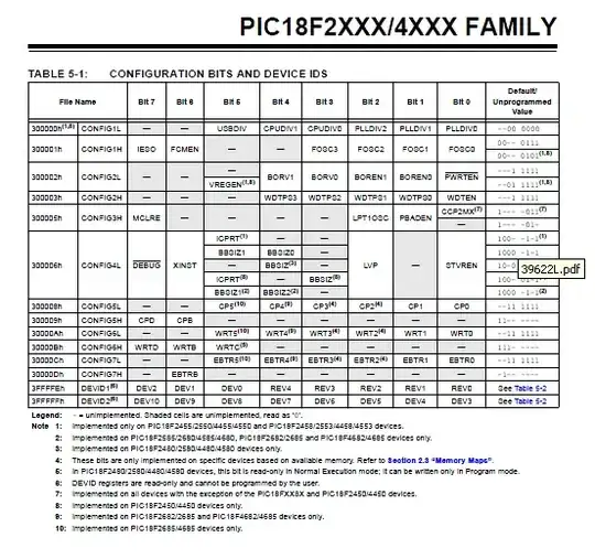

If you look in the Flash Programming Specification for your device (document DS39622L in your case) you'll see this table which includes the device ID bits:
There are two Device ID bytes DEVID which you should be able to read along with the config bits in MPLAB. The device ID bits include a 5-bit revision code.
The errata sheets for the different revisions give a revision code, so you can match this bit string with the right revision code. e.g. the rev A3 code is 0 0100, whereas the rev B1 code is 0 0111.
