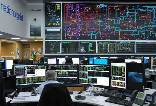

You're confusing an accurate number of cycles over a 24 hour period with very rigid instantaneous frequency control. That's not how it's done in most places.
The frequency is maintained at around its nominal frequency by matching generation to load - all the time that the load is greater than the generation, the frequency will be (very) gradually falling, and all the time the load is less than the generation the frequency will be increasing.
The inertia is enormous and, in general, both load and generation change fairly gradually, so there's lots of time to make adjustments to generators (or loads, where people have contracted to control their loads in this way) to keep the system balanced. The frequency is allowed to drift between various limits (operational and regulatory).
In the UK at least, the correct number of cycles per day is maintained by keeping track of 'real time' and 'grid time', and the grid is run a bit fast or a bit slow to make sure they don't get too far apart.
There are accurate frequency references in use within the grid control system - that's what they're comparing with/measuring against, but the grid itself isn't phase/frequency-locked to them in any direct way.
At the bottom left of the big display in this image is a graph with a vertical wiggly yellow trace - that's the frequency of the UK National grid for a while before the photo was taken - as you can see it's not locked to anything very tightly, though the graph is probably only about ±0.3 Hz.

  • Cool information and picture thanks. Yes I read elsewhere the total cycles per day is the actual measure that is controlled. Still leaves me wondering what mechanism is used to tweak it into count though... – Trevor_G Mar 09 '17 at 17:24
  • Or is it simply a grid wide control knob that tells everyone to speed up the generators a bit in a tolerable amount of unison. – Trevor_G Mar 09 '17 at 17:30
    Or is it simply a grid wide control knob that tells everyone to speed up the generators a bit in a tolerable amount of unison - Yes – Neil_UK Mar 09 '17 at 17:50
  • As an engineer and musician, this is interesting. The old Hammond organs derived their tuning from (instantaneous) mains frequency. 0.3Hz in 50Hz works out at about 1/10 of a semitone, which is noticeably out of tune. But If you mean the axes of the graph are +/-0.3 Hz then the trace is only about +/-0.1 Hz, which is hard to detect. – Level River St Mar 09 '17 at 20:22
  • Sort of: all generators are always in unison with the grid at their point of connection, but any individual generator can vary their current (I) output by controlling mechanical shaft power. – pjc50 Mar 09 '17 at 21:39
  • @LevelRiverSt you can read the labels on the graph if you zoom in and squint; the trace does indeed cover a range of +/- 0.1 Hz. – hobbs Mar 10 '17 at 07:09
  • @LevelRiverSt a little research says that National Grid has a legal requirement to stay within 1% (+/- 0.5 Hz), but aims for +/- 0.2 Hz as a matter of regular practice. The continental European grid (ENTSO-E) also has a +/- 0.2 Hz standard. The US has stricter limits, with the NERC having a "trigger" limit of 0.05 Hz (in the Eastern region) and 0.144 Hz (in the Western region) deviation from 60 Hz, and "emergency" limits of 0.092 Hz (Eastern) and 0.2 Hz (Western). Frequency is within 0.05 Hz >99% of the time. That's less than 2 musical cents. – hobbs Mar 10 '17 at 07:45

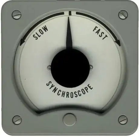

They use a Synchroscope. I have seen this done in power plant control rooms.
https://en.wikipedia.org/wiki/Synchroscope
user125718
  • 407
  • This is the right answer IMO, but only for small generators (<500 KW), and at small power limits (<2 MW). But this misses the use of automation to manage tap switchers and close the contactors (It's not done by human eye on large alternators) and for grid level balancing (100 kV and above) it's normally done with DC drive (Thyristors). See articles such as this: https://library.e.abb.com/public/793bfb6d691ddf0bc125781f0027d91f/A02-0223%20E%20LR.pdf – Jack Creasey Apr 27 '17 at 20:45
  • This is definitely wrong. A synchroscope can only display a difference in phase and frequency. When a synchronous generator is already synchronized with the grid the synchroscope always points right upwards. That's the very nature of synchronous generators. When they are synchronized and connected they are perfectly in phase like there was a 1:1 gear box or a single shaft between them. – Ariser Sep 30 '21 at 14:25
