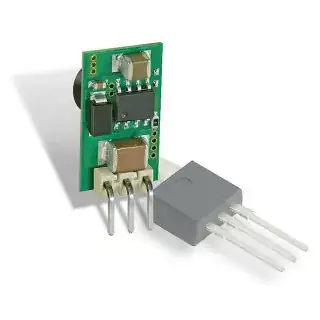

AndrejaKo made an interesting remark. There are switcher modules which can be used as drop-in replacement for a TO-220 linear regulator:
Like he says these aren't cheap but may be the right solution if you need an efficient regulator but don't have the experience to design a switcher yourself.

    Another interesting options are the drop-in replacement switchers for the 3 leg linear regulator. They have a switching regulator and all needed extras in a single package that can be used instead of say LM78XX but they are much more expensive. Still for a low number of units, they could be interesting. – AndrejaKo Apr 02 '12 at 08:06
