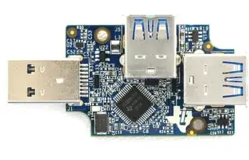

Recommendation 1
TI's TUSB8020B hub reference design TIDA-00287 ties all shells directly to ground.
Intel's EMI Design Guidelines for USB components also recommends to tie to ground (although this was written for USB 2.0).

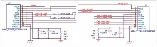

Recommendation 2
TI's TUSB8020B EVM (and datasheet) connect shields together, and to ground using RC filter:
Microchip's EVB-USB5534 also ties shields together and uses an RC filter, but a 3 orders of magnitude smaller R:
