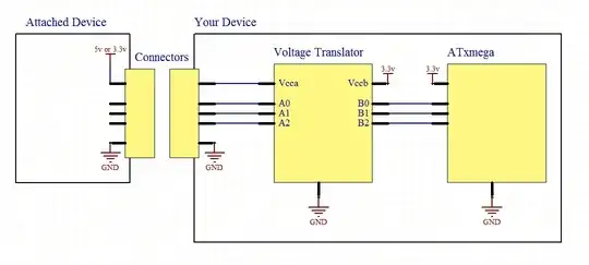

The question is: How will your device know what voltage to use? The attached device will have to tell it some how. Will your device have a sense pin so it can test the attached device's supply voltage?
If so, the answer is easy. There are many voltage translators out there, e.g. the TI SN74LVC8T245. The input power supply will be your Atmel's 3.3v, while the output voltage supply can come straight from your device. This way, you will be able to connect a device with any voltage requirement from 1.65 to 5.5v, and it should just work.
Schematic

Just use a level-converting buffer that can accept a wide input voltage range. There are many companies that make them. The TI SN74ALVC164145EP is one of them, but there are hundreds more with different speeds, capabilities, voltage ranges, and number of bits.
