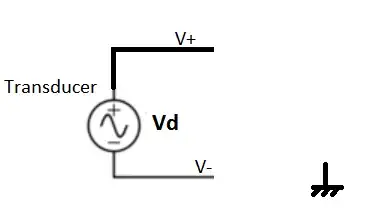

Lets say I have a differential signalling mode floating battery powered transducer(where the outputs are mirrored) and the differential voltage across its outputs Vd at a moment is 1V.
Lets call the output wire pairs as V+ and V-. At this moment I only know the differential voltage between V+ and V- by using a voltmeter or a scope as 1V.
Below illustrates the transducer and its differential outputs:
But in the above situation I dont know the voltage across V+ and the earth ground and similarly I dont know the voltage across V- and the earth ground.
Lets say I measure the voltage across the V+ and the earth and V- and the earth and I measure them as 101V and 100V respectively keeping the differential voltage as 1V again.
Imagine I hook up this transducer outputs to a differential amplifier where its system analog ground is earth grounded. I draw the equivalent circuit as:
In this case, the common mode voltage Vcm = (100 + 101)/2 = 100.5V

  • What you have here is a system where your sensor is at +100 V ground level and your amplifier is at 0 V. Yes that would blow up that amplifier. What you're forgetting is that you cannot transport a differential signal using only 2 wires without re-defining the ground level (a transformer can do this). You also need the ground. So the sensor must also be at 0 V ground level or the amplifier must also be at +100 V CMM level. – Bimpelrekkie Mar 05 '17 at 16:30
  • Do you mean that in differential signalling, the transducer's GND must be connected to system ground of the differential amplifier? – user1245 Mar 05 '17 at 16:35
  • I think in my question without any common ground current cannot loop, was that your point? – user1245 Mar 05 '17 at 16:39
  • You said the common mode voltage was 100 V. When you say that you mean "relative to ground". And your "equivalent circuit" shows a Vcm source connected from ground, which provides a path for current to flow. – The Photon Mar 05 '17 at 16:41
  • If you apply a 100 V common-mode voltage to an amplifier with 15 V maximum common mode input voltage, you will most likely blow up that amplifier. Why is that difficult to understand? – The Photon Mar 05 '17 at 16:42
  • read my second question – user1245 Mar 05 '17 at 16:42
  • One issue is that what you drew as an "equivalent circuit" is not equivalent. I explained this in an answer to your earlier question. – The Photon Mar 05 '17 at 16:45
  • It is not equivalent? Sorry it means I still didnt get the concept well. My aim not to pollute here but Isnt Vcm = ((V+)+( V-))/2 where V+ and V- is the voltages wrt to ground/system ground? – user1245 Mar 05 '17 at 16:47
  • Yes, but your "equivalent circuit" shows that as being established by a low-impedance source, not by a high impedance due to separated grounds, which your text says you want to talk about. They are two different things. – The Photon Mar 05 '17 at 16:48
  • Do you mean that in differential signalling, the transducer's GND must be connected to system ground of the differential amplifier? Yes, it must it is possible not to do this but then you would need to take measures to "level shift" the +100 V commonmode level of the sensor to the 0 V commonmode level of the amplifier. – Bimpelrekkie Mar 05 '17 at 19:28
  • @FakeMoustache Thanks. I see.. Thats for bringing the common mode voltage to low level right almost to zero? But then does that mean first the grounds of the transducer and the receiver must be connected before connecting the differential outputs to be on safe side? – user1245 Mar 05 '17 at 20:17
  • Yes, because if you'd connect the ground later you could for a moment have a 100 V commonmode level. And that would damage the amplifier. But if you connect the grounds first and make sure the signal lines do not have a voltage of more than +/- 15 V from that ground, the amplifier would not be damaged. – Bimpelrekkie Mar 05 '17 at 21:54
