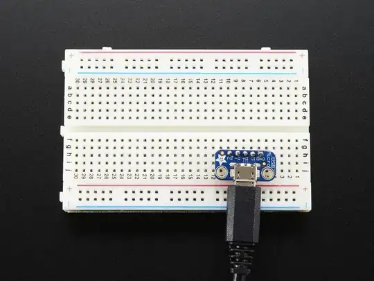

Because the family has so many tablets \ cell phones we tend to have charging 'stations' as shown in the diagram: the 5V charger that comes with the cell phone \ tablet are repurposed for breadboard projects. You can also (with permission) find assorted DC power supplies from discarded electronics (BestBuy).
Why risk damaging your computer when 5V supplies are inexpensive and plentiful?
Caution should be exercised: calculating the required current to operate your circuit and ensuring that this does not exceed the rating of your power supply / wiring is key to protecting your circuit and avoiding fire risk.
USB Micro-B Breakout Board (Adafruit \ Amazon):
Power supply example:
