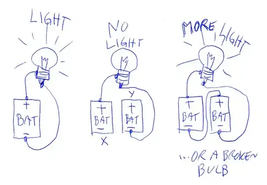

I'm new to learning about electricity. I have learned that Electrons moves from - to + when there is a voltage differential.
My conclusion is, that I can connect the plus side of one battery to a bulb, and connect it to the minus side of the second battery without closing a circuit.
This way, the electrons will move, and the bulb will light?
Is it will light for at least a few nanoseconds?
Bonus: There is an online website that can help me create the diagram and test it? or just share here the image?
Is it the truth that the bulb will be lighted for a few nanoseconds? (see answers below)

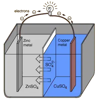

You may have a look at this site: http://hyperphysics.phy-astr.gsu.edu/hbase/Chemical/electrochem.html enter image description here
"In order for the voltaic cell to continue to produce an external electric current, there must be a movement of the sulfate ions in solution from the right to the left to balance the electron flow in the external circuit"
Because that ions can't move between the two batteries, your bulb will not produce light.
mic
  • 996
  • 14
  • "Must be a movement of the sulfate ions in solution from the right to the left to balance the electron flow in the external circuit" Why? – Aminadav Glickshtein Mar 02 '17 at 10:28
    If you don't have a complete, circular path for current flow, none flows. End of story. That is the "WHY". It's like laying on the ground. You can't fall, you are already at the lowest possible energy potential. Now if someone pulled the ground out from under you, you would fall to the new ground level, releasing energy. – R Drast Mar 02 '17 at 11:28
  • The reason is that the ability of the battery to displace charge depends on a dynamical equilibrium between electrode and solution. When you 'remove' one electron from the zinc electrode, you alter this delicate equilibrium and in order to re-estabilish it you must remove (or, if you wish, neutralize) a Zn++ ion. The SO4-- ion coming from the other side will do that more than gladly. – Sredni Vashtar Mar 02 '17 at 13:17

The current needs a closed conductive path. In the vacuum the electrons can propagate without a conductor, but not in the air.
Let's imagine that the middle scenario makes light (=current) Then the total amount of electrons would grow at the other battery. Finally they will push so strongly the new ones back that the current stops.
ADDENDUM: But how long the current exists and how much electrons flow through the bulb if we put together the system in the middle? For that exists the concept named"capacitance". Imagine to put the system together instantneously (=in no time) Then the electric fields of the batteries push and pull the electrons until new balance is found. There really is a current until the capacitance between X and Y is fully charged. Assuming the capacitance to be a few picofarads and the total resistance in the parts max. a couple of Ohms, the current stops well before one nanosecond. The total moved charge is well below one nanocoulomb. If the battery voltage is 12 volts, then the total dissipation in the bulb is so low that no observable filament warmup exists in the bulb - no light, but a short current pulse yes, but in practice also not observable.
  • Thanks! The question is WHY electrons do not pass from the + to the - in the middle image. The are a lots of electrons in the left battery and not enough electrons in the right battery. They want to be in a balance, so they should move! – Aminadav Glickshtein Mar 02 '17 at 10:36
  • So, how much time do you have until the current stops? You will get a 1 second or 1ms of light? – Aminadav Glickshtein Mar 02 '17 at 10:44
  • There is no mismatch in the count of electrons on batteries. – pjc50 Mar 02 '17 at 12:15
  • @Aminadav Moved my chatting to the answer and completed it, too. –  Mar 02 '17 at 13:37

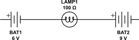

You have made a good start in recognizing that electrons that are moving cause the lamp to light. Your circuit is in static equilibrium (redrawn below with stackexchange's menu-bar circuit-drawing facility):
schematic
No electrons move in the above circuit. The negative end of BAT1 is at the same voltage as the positive end of BAT2. So no electrons move through the lamp, and there's no light.
However, if you measure the voltage from the positive-end of BAT1, to the negative end of BAT2, you'll measure 6+9=15 volts. Both batteries need to do no work.

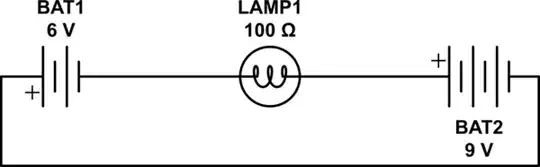

Perhaps your error is in assuming that these loose ends are at the same potential voltage. If you force them to be at the same voltage by connecting them with a low-resistance wire, electrons now flow (revised circuit below). LAMP1 has 15 volts across its terminals. This is a series circuit, with BAT1, LAMP1, and BAT2 experiencing the same electron flow (current).
schematic
simulate this circuit
