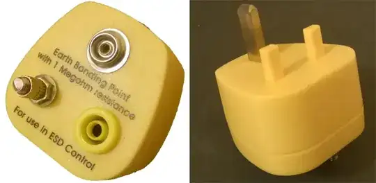

You can get plugs specifically for the task, although the expense is probably not warranted for a one-off use:
The live and neutral pins on the plug are plastic. The one illustrated conveniently has press-stud, screw terminal, and 4 mm banana sockets.
It is OK to attach an anti-static wrist band which already has a 1 MΩ resistor.

  • To be doubly sure, you could plug in a passive outlet tester first to make sure the safety ground isn't somehow hot. – Todd Wilcox Feb 26 '17 at 20:20
    @ToddWilcox -- I'd actually check the receptacle strap with a non-contact voltage detector instead of using a 3-light "passive" outlet tester (one of the most common ways to get a live earth connection on a receptacle can't be caught by a 3-light tester -- look up "reverse polarity bootleg ground" for more info) – ThreePhaseEel Feb 26 '17 at 21:28
  • Thank you for that info. Those ESD plugs do look like a nice option to have. Are they what gets typically used for full ESD setups? – Smiith Feb 27 '17 at 01:49
  • @Smiith I wouldn't know: I only got one because it was convenient for me to use. – Andrew Morton Feb 27 '17 at 19:54
