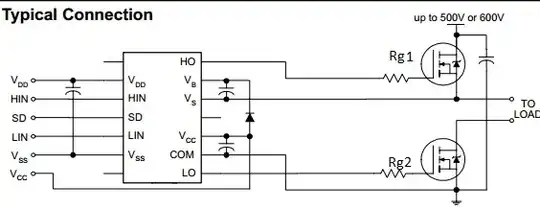

I need to drive a MOSFET IPW90R120C3 from Infineon here the Specification of MOSFET
VDS @ TJ=25°C 900 V
Rdson @ TJ=25°C   : 0.12ohm
Qg = 270nC
Specification of driver IR2110
Isource: 2A
Isink : 2A
VOUT 10 - 20V
ton/off (typ.) 120 & 94 ns
Driver supply : 15V
The switch frequency Fsw= 50KH
what the best way to calculate the resistance Rg to drive proprely the MOSFET ? best regards

  • I bet it is the maximal gate current. The MOSFET gate is capacitor like, therefore it will sink/source current $I_g=\dfrac{V_g}{R_g+R_{g_{internal}}}$ – Marko Buršič Feb 20 '17 at 22:19
  • UPDATE: The maximal current of the gate driver on the picture. – Marko Buršič Feb 20 '17 at 22:24
  • @ Marko Buršič, Yes it is the maximal gate current. I searched and read many Application notes from supplier , but did not find a specific answer or a genaralist formula to calculate the correct value for a Rg resistor for a MOSFET's. the right formula must includ the Gate Charge Qg, and the swithing time turn ON - Turn OFF, Or by using the Output voltage slop dVout/dt – user3212448 Feb 20 '17 at 22:29
  • @user3212448 I can finish my answer tomorrow. With Ig and Qg you can calculate the switching time, if you need steeper dV/dt (faster turn on/off) then you need a driver with greater Iout. – Marko Buršič Feb 20 '17 at 22:37

You should look on datasheet of the gate driver circuit, then look for max. current and \$R_{ds_{ON}}\$, look for internal gate resistance of the MOSFET, too. $$I_g=\dfrac{V_{driver}}{R_{ds_{ON}}+R_g+R_{g_{MOSFET}}}$$

The gate driver you have chosen is not a good fit. The Source/Sink Current is 2A, but if you calculate the Ig based on Turn On Time (90 nS) and required gate electric charge, which is 270 nC: Ig= dQ/dt= 270/90= 3A (at least this 3A is required, I would go for 5A)
