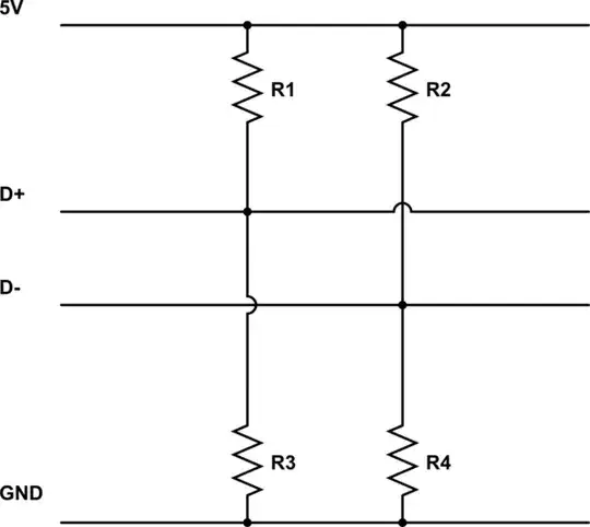

The standard USB qualified method for telling a phone that it can fast charge is to short the D+ and D- lines together. (USB calls this out in its documentation)
The non standard way is to place voltages on the data lines.
schematic
The usual way this is done is using two resistor dividers. What is unfortunate is that these voltages are all different depending on your device. If your chargers is capable of fast charging your phone then measure the voltages on the data pins and set up your own dividers to get those same voltages.
ePanorama had a great aggregation of the information on fast charging USB ports as it related to Apple devices. This APC article discusses the variation in D-/D+ voltages used by various manufacturers.

  • Do I unerstand right that shorting D+ and D- works for everything, but placing resistors to them (which costs more) doesn't always works? If so, why are chargers I bought from eBay using the resistor method it it doesn't always works? – Adam Ježek Feb 16 '17 at 23:03
    @AdamJežek No, you have that wrong. USB consortium made a standard that shorting the data pins together means fast charging. About half to three quarter of OEMs use it. The rest roll their own. This is why i suggested measuring the voltages and reproducing them on the other port. It sounds like your phone falls into the "roll their own" category. You could try bridging the data pins together with a bit of solder to see if your phone likes it. My phone will fast charge from both an iphone charger or from shorted data pins. – vini_i Feb 16 '17 at 23:12
  • I have Samsung Galaxy, but I would like to to bude usefull for more. Is there any list of manufacturers where could I find if they use shorted/which voltage, or do I have to use the trial-error method? – Adam Ježek Feb 16 '17 at 23:29
  • @AdamJežek I wish there was such a list. Trial and error is about the only way right now. – vini_i Feb 16 '17 at 23:31
    Here is a list of what different chargers use on D+/D-: http://electronics.stackexchange.com/a/271681/117785 – Ale..chenski Feb 17 '17 at 18:49
