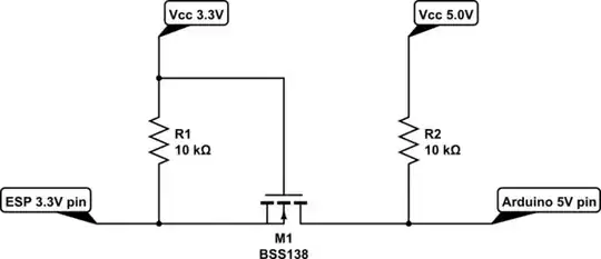

You can use any N-Channel MOSFET, not just BSS138.
It is pretty simple. This is bidirectional level converter:
schematic
UPDATE:
By "any" I meant any jellybean small signal mosfet. Simply with low Vgs voltage threshold.

    You cannot just use any MOSFET; most have a too-high gate threshold. – CL. Feb 14 '17 at 18:19
  • You are right. I meant any jellybean small signal mosfet. I will update it. – Chupacabras Feb 14 '17 at 18:35
  • Will IRF510PBF / IRL540NPBF be a suitable replacement? – Adrian Ilie Feb 14 '17 at 21:10
  • No, IRF510PBF / IRL540NPBF are not suitable. Those are power mosfets. They are beefy and costly to do just level conversions. IRL540NPBF will work, it has Vgs less than 2V. But it is better to use smaller mosfets for this task. – Chupacabras Feb 14 '17 at 21:18
  • I found one more that i think will work IRLU120NPBF and is 30% cheaper than IRL540NPBF. – Adrian Ilie Feb 15 '17 at 09:09
  • private, you are looking for bad types. This is again a power mosfet. You do not need such chunky TO-220 mosfet just for signal level converting. Yes, it will work, but it is really heavyweight for the task. If you want through-hole one, you can use TO-92 package, like 2N7000, BS170, etc.. If you want SMD one, you can use something like 2N7002, BSS138, etc. – Chupacabras Feb 15 '17 at 09:23
  • Unfortunately my local retailers have horrible websites and i have to manually search every product datasheet, without any filtering whatsoever. Luckily i found BS170 in stock. Thanks a lot you for your help. – Adrian Ilie Feb 15 '17 at 10:28
  • Yes, BS170 is pretty much a jellybean part ;) If you have problems with local suppliers, you could try ebay or aliexpress to get such basic parts. You can get 10 pieces of BS170 or 2N7000 under 1 USD. But you would have to wait for it a month. – Chupacabras Feb 15 '17 at 10:37
