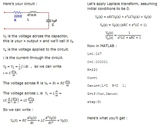

Description of equations

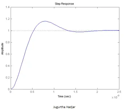

Figure swhoing overshoot
You see there's a slight overshoot, if you are familiar with "damping coefficient" (or you can look it up) you'll see that tinkering with the values of L & C will vary the overshoot (or eliminate it).
You can download the PDF instead of the images if you wish to have it on your computer:
http://bit.ly/StepResponseRLC
Any further questions, feel free.
