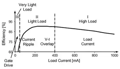

In general, a DC-DC converter (buck or boost) will have two methods of operation: PWM or Pulse Skipping. To pick between the two different modes, I would look at the efficiency curve in the datasheet and the load that you have. Take a look at the graph below to get an idea of what you would need to look for.
