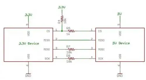

The Sparkfun tutorial is generally good but contains one horrendously bad piece of advice,
The Sparkfun resistor and diode solution is safe but pulldown or low is to about 0.6V and pullup is slow compared to a gate switching as the 10k resistor must charge gate an stray input capacitance. These effects often will not matter.
The Sparkfun MOSFET solution is excellent - although the MOSFET used is somewhat marginal at 3V3 gate voltage.
The Sparkfun series 10k resistors in each line is an invitation to disaster and random problems forever.
DON'T DO IT !!!!
To maintain the IC in spec sheet limits Vin <= 3V3 so current flow in the 10k resistor = V/R = (5V- 3v3)/10k = 170 microamps.
170 uA is not very much in most normal circumstances + here it is very likely to drive the pin above 3V3. Catch diode conduction begins reasonably noticeably at about 3.8V and is in full swing by 4V. At 4V you can expect about (5-4)/10k = 100 uA. This current will often be injected in the substrate of the IC in places it was never designed to go and can cause parasitic transistor or can latch nodes in existing devices by inpecting charge that cannot dissipate into floating nodes
MANY people argue violently against the above. They say that it is OK to violate spec sheet limits and to inject current into places that it does not belong and that such actions are consistent with good engineering practice. Walk away lowly from such people with your hands in sight.

In the case of protection diode currents
10 mA will almost garantee disaster and 1 uA will almost guarantee no observable problems.
At 1 mA and 10 uA you are likely in trouble and likely OK.
At 100 uA and 100 UA (ie they meet) you are in a grey area and anything may happen and sometimes does. It can be random, intermittent and project and sometimes product destroying. Occasionally may be life destroying.
Good engineering and Murphy say that you do not go outside spec sheet min-max range.
