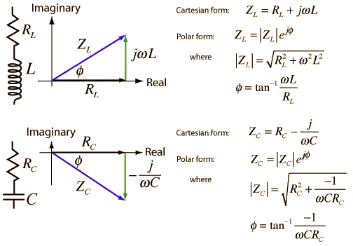

  1. The descriptions below SEEK to demythologise what is meant by "complex" quantities in an R C L context. The concepts of 'imaginary" components are a useful metaphor which tends to blind people to the simple underlying realities. The text below talks in RC terms an does not touch on the mysteries of LC which are in fact no more mysterious in reality.
  2. It would be of greater benefit to you to do your utmost to address most of the points raised yourself using either a text book or internet search engine prior to seeking explanations from others BECAUSE this question is so very fundamental to the basics of AC circuits with reactive components. Dealing with difficult questions sets a precedence with how you will deal with similar things throughout your education and the internet has probably millions of pages dealing with this subject (Gargoyle says ~= 11 million but who can tell?). The degree of detail and thoroughness you ask for is unrealistic from a site like this given the vast truly amount amount of detail "out there". (Unless the site owners are trying to replicate a subset of Wikipedia).
SO - I wot that helping you get your head around the basics is a good idea so that you can pick it up and run with it from there. So ...
If you connect an input terminal to a series resistor to a capacitor and the other capacitor is "grounded" you get a series RC circuit:
Vin - resistor - capacitor - ground.
If you now apply a step voltage to the input the capacitor current will step to match but the capacitor will start to charge using this voltage to produce current in the resistor. The voltage increase will be exponential because the current flowing into the capacitor will beset by Icharge= V/R = (Vin-Vcap)/Rseries. ie as Vcap rises the potential across the resistor falls and so current decreases. In theory it will take an infinite time for Vcap to reach Vin but in practice it is more or less" there in about 3 time constants where
t = RC = the time taken for Iin to fall to 1/e th of its initial value. The what and why of the 1/e term you already know or will do after reading the references.
NOW, if we apply a square wave signal the capacitor will charge as above when input is positive and will discharge in a similar exponential manner when the input is grounded or negative. While the capacitor current will follow Vin and will be maximum when Vin transitions high/low or low high, the capacitor voltage, for the reasons described above will lag behind the input voltage. Once steady state has been achieved, if you plot Vcap and I cap you will find two waveforms offset by up to as almost 90 degree or as little as almost degrees where one whole input cycle = 360 degrees. How far the capacitor voltage is lagging behind its current depends on the input frequency and the RC time constant.
To the uninitiated this may look like magic (or the use of thiotimoline*), with a current waveform occuring up to 1/4 of a cycle before its voltage BUT this is just because the logical reason for this, as explained above, is not necessarily intuitively obvious on inspection.
If you start combing capacitors and resistors and inductors in various ways you need to be able to deal mathematically with the relative phases of the various waveform. [At first introduction it may seem that the phasors are set to stun].
Some competent figuring, or a sneak look at some of the 10 million or so web pages on the subject, will indicate that where you have two waveforms that vary in phase relation ship to each other and which are based on a mutual exponential relationship, then each waveform can be represented by a polar representation of the form [R,Theta] which in term can be represented as a complex number which has X and Y components which reflect the polar form.
The Polar "vector" which represents the voltage and current relationship in a given situation uses a rotating vector arm “metaphor” giving length of arm and phase angle relative to a reference. This “metaphor” can be replaced by an X and Y component where the magnitude of the polar form is given by R = sqrt(x^2 + y^2) and whose angle theta is given by tan^-1(X/Y) . This can be seen in diagrammatic form below.
From here
WARNING - don't be fooled by the terminology.
Note that the term "complex number" is simply Jargon. The use of sqrt(-1) is a useful part of the metaphor which allows the arithmetic to work BUT the actual quantities involved are entirely real and "ordinary". When reactive elements such as inductors and capacitors are used power will no longer be simply the product of the magnitude terms in the voltage and current vectors. ie The power from V.sin(fred) x I.sin(Josepine) does not (usually) = VI. This does not imply anything special or magical or complex or imaginary about the variables involved - it's just that they are time variant and their peak magnitudes will usually not coincide.
