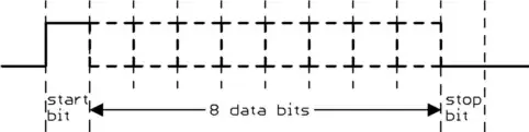

For example, consider the common RS-232 protocol. Let's say we're using 9600 baud, 8 data bits, one stop bit, and no parity bit. One transmitted "character" looks like this:
Since the baud rate is 9600 bits/second, each time slot is 1/9600 seconds = 104 µs long. The character consists of a start bit, 8 data bits, and a stop bit, for a total of 10 bit time slots. The whole character therefore takes 1.04 ms to transmit.
However, only 8 actual data bits are transmitted during this time. The effective bit rate is therefore (8 bits)/(1.04 ms) = 7680 bits/second.
If this were a different protocol that, for example, used four voltage levels to indicate two bits at a time with the baud rate held the same, then there would be 16 bits transferred each character. That would make the bit rate 15,360 bits/second, actually higher than the baud rate.
