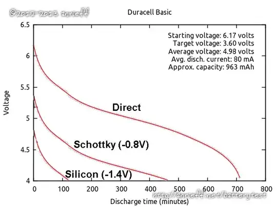

I was wondering if Schottky diodes would be the best option because of there low forward voltage drop?
Probably. A typical 6V dry cell battery has useful capacity down to ~4V (1V per cell) and your telephones are probably designed to work down to this voltage only (if they could use a lower voltage then why have 4 cells?).
A silicon bridge rectifier drops ~1.4V (about the same as having one flat cell) which may significantly reduce the operating time. A Schottky bridge drops ~0.8V.
Here's an example 6V AA discharge graph. I have copied the original curve to show what you would get with 0.8V and 1.4V drop through the rectifier. In this example (80mA average current draw) the ~12 hours run time is reduced to ~7.5 hours with a Schottky bridge and 2 hours with a silicon bridge.
In practice it might not be quite this bad because the current draw will probably be less at lower voltage, but you get the idea.
