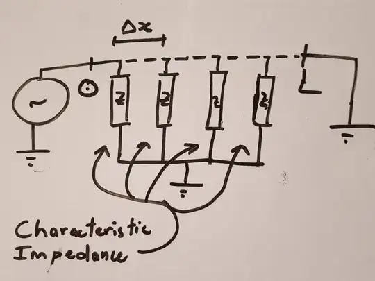

An intuitive approach but nothing more!:
If you agree that the charactertic imepdance of a transmission line is defined as the ratio of the voltage wave divided by current wave at any POINT, then it is easy to see intuitively why this is constant.
When I say POINT, i an literarly refering to an infestesimally small length of the transmission line.
So as a mental picture you can imagine the transmission line made up of many fictitious resistors of value equal to the characteristic imepdance. So when you refer to the characteristic impedance you are refering to simply ONE of that fictitious resistors value. See the photo below:
Do you now see why the characteristic impedance is independant of the length of the line and independant of the POINT of measurement? (Because changing the length of the line merely changes the number of copies of the fictitious resistors but not their value and hence the characteristic impedance)enter image description here
MAM
  • 1,831
  • 16
  • 24
  • then shouldn't it be ohms per unit length – JobHunter69 Jan 20 '17 at 23:18
  • No. This is not an actual resistor as i insist. It cant be defined as unit length because the whole basis of its derivation in the math is that we consider an infintesimally small length i.e. limit -> 0. So really we are considering a POINT. There is no length to consider. – MAM Jan 20 '17 at 23:25
  • Look at the picture, imagine measuring any one resistor. Would the value depend on the length of the line in anyway? So why do you say ohms per unit length? – MAM Jan 20 '17 at 23:37
  • Why are they connected to ground? – JobHunter69 Jan 20 '17 at 23:38
    Where else would they be connected? – MAM Jan 20 '17 at 23:40
    This is half-right, but the resistors are wrong. The components at each step are an inductor and capacitor. – pjc50 Jan 20 '17 at 23:47
    @pjc50, actually, if you look at the Adil's picture, they are not just "resistors", they are "Zs". So there is no contradiction. :-) – Ale..chenski Jan 20 '17 at 23:51
  • It is not half right. Characteristic impedance comes out purely real for a loss less line. So it is exactly like a fictitious resistor as i said, but to illustrate that this is not true to the physics of distributed reactive elements i denote them using Z. Transitioning from the reactive component based image to this one is essential in conveying the intuitive answer the OP asks for. – MAM Jan 21 '17 at 00:26
