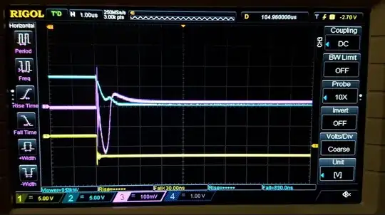

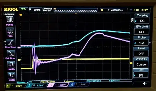

Oscilloscope:
Note: apparently the input signal was inverted on the oscilloscope by setting. I'll update the screenshots later...
enter image description here enter image description here enter image description here
Also, I've included the base of the PNP in the following screenshots. Is it supposed to look like this? It looks a bit funky.
It seems the problem is that the NPN stays switched on, thus preventing the gate from charging.

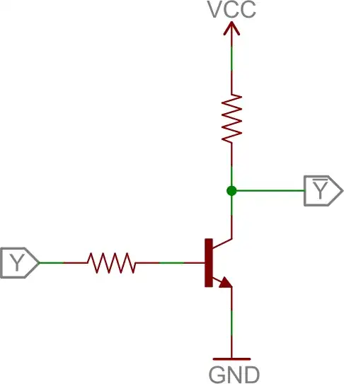

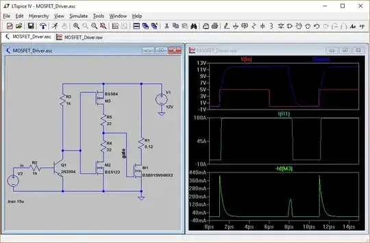

Other folks have already suggested IC MOSFET drivers. Sounds like you really want to do a discrete driver.
Here's a circuit and it's basically what would be inside a driver IC. This results in 100 Amp switching with about 100 ns transition time to keep MOSFET power dissipation at a minimum.
Q1 is a simple inverting level translator to get the signal swing to 12 Volts. M2 and M3 form a MOSFET push-pull driver. R4 and R5 are there to limit the shoot-through current to prevent damage to M2 and M3 because as their gates transition between 0 and 12V they will be both on for a small fraction of time.
Without R4 and R5, the shoot-through current would exceed their maximum drain current ratings. In an actual IC, M2 and M3 would be sized small enough to have high enough Rds-on instead of putting actual resistors.
Additionally, M2/M3 does an inversion to get back to normal logic. Finally, M3 serves as the high current driver to handle the 100 Amp current.
Note that there is about 2 us delay in shutting off M1. If you're not switching your load at a high frequency, then this 2us would be of no concern.
I definitely would not recommend using these parts; I just picked these from whatever LTspice had. For example, M1 is limited to 35A continuous, so replace these parts with something appropriate for your design and re-run the simulation. Then test out in your prototype to confirm performance. Anyway, this circuit might be a good starting point for you.

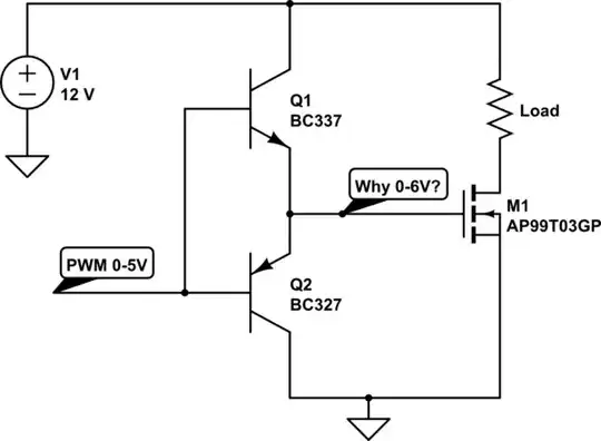

The first version - a push-pull emitter follower should be fine if only the max available mosfet VGS = +4,3 V is enough. The pulldown resistor about 100 Ohm should be inserted from BJT emitters to GND to ensure mosfet's off-state, because the PNP does not pull down effectively under +0,7 V. Additionally a few Ohm damping resistor inserted just into mosfet's gate terminal should prevent some ringing caused by capacitance and wire inductance.
Your second version has a shortcut. Think about the current route Q2 base->R3->R2->Q1 base.
Emitter follower has no saturation and thus no turn off delay due the diffusion capacitance.

< why 0-6v?
Q2's emitter is 0.7v above Q2's base, which is 0-5v. That's your answer.

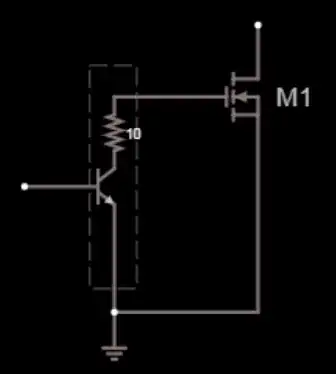

I'm a bit worried that the gate voltage isn't dropping low enough, e.g. seems to stay at around 400mV. Although ground seems to be read at 250mV, so maybe the breadboard is just crappy. How low should the gate voltage be to prevent any heat build-up in when the signal is constant low (off)?
It seems that MOSFET M1 is not getting low resistance path for proper turn off. It can be provided through a transistor to GND. This way M1 gate will discharge fastly.
