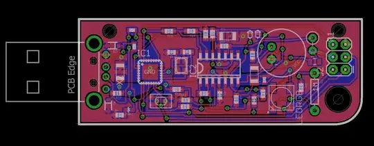

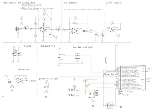

I am using an ATtiny167 Atmel chip on a custom PCB board I’ve designed.
I prototyped the board with the sensors and a Digispark (Getting started, Upload Bootloader) as the ADC and serial connection. I've had the board manufactured (multiple times) and am now trying to communicate with it.
I've attempted to load a bootloader via ISP (something has been loaded), and then tried talking to it with my Windows 10 PC via USB:
PCB Design Eagle BoardPCB Design Eagle Schematic

When I plug in the device to my computer in the USB port (COM6) I get “USB device not recognised”. The driver (in Device Manager) is “Unknown USB Device (Device Descriptor Request Failed)”.
I have tried selecting the driver by: Update DriverBrowse my computer for driver softwarelet me pick from a list of device drivers on my computerHave Disk…Browse… and then attempted to select the appropriate .inf file:
“The folder you specified doesn’t contain a compatible software driver for your device. If the folder contains a driver, make sure it is designed to work with Windows for x64-based systems.”
I have also selected the file containing the appropriate drivers, but I receive the error “Windows has determined that the driver software for your device is up to date.” And when using the Arduino IDE like you would a Digispark, no device is recognised (times out). I have tried the same drivers on other Windows machines, with the same results.
What am I doing wrong, and how can I fix it?
I think the problem is with setting the fuses, but I'm not sure which configuration is correct, and how to test it.

From reading through your question, and having looked through the micronucleus repository, your problem is down to fuses/clocks.
Firstly, and while not immediately obvious (not documented anywhere but the code helpfully), the ATTiny167 micronucleus bootloader requires a 16MHz external clock source in order to run. You are using the internal 8MHz oscillator which will not allow the bootloader to function at the correct frequency and so USB emulation will fail.
Secondly, when you tried to use your external crystal, you used the wrong fuse settings and so were not in fact enabling the crystal. In the Engbedded Fuse calculator, the clock option for "Ext. Clock – XTAL1" does not a select to use an external crystal, it requires you to feed a CMOS/TTL clock signal into XTAL1. Incidentally selecting this with a crystal connected to the XTAL pins will brick the chip and prevent ISP due to a lack of any clock source.
The solution is to use the correct fuse settings. You will need to select the clock option for "External Crystal - 8-16MHz" which will enable the internal crystal oscillator circuitry and allow a clock to be derived from your crystal. From the calculator, assuming no BOD enabled (up to you if needed), and self-programming enabled (needed for bootloader), the following fuse settings are required:
  • Low: 0xFF
  • High: 0xDF
  • Extended: 0xFE
Once you enable the 16MHz clock source, your bootloader should function correctly assuming no other hardware issues.
