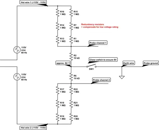

I'm considering using this circuit to reduce the voltage (from 230 VAC to 2.27 VAC). Since there are two hot wires, the voltage divider has to go in both directions. Also, the high resistance should reduce the short-circuit current to about 0.23mA, greatly reducing the outcome of a worst-case scenario.
I'm assuming the answer is: yes, the probe will now be safe.

I'm thinking to use the differential measurement on the oscilloscope to add the two signals.

  • I've updated the schematic. I'm a bit confused because I'm used to working with DC circuits. I'm guessing that one wire would normally be neutral, but in my case with the inverter, to measure 0V, I'd have to be in between the two wires (the center of the voltage divider). The earth wire might be at zero potential, but I'm thinking that it shouldn't be used as a circuit path for safety reasons, but can be used by the oscilloscope as a reference point (probably already connected if powered from the same circuit) – user95482301 Jan 15 '17 at 09:02

As for your voltage divider, that's a safe and good way to divide the voltage down to suit your probes and scopes. You are however on your own if you where to connect it to CAT II or above since you need to guarantee the overvoltage and breaking capability of the divider yourself. A fuse would be the first step in doing so. Professionals use categorized probes for it but they are in CAT II+ envoriements, you are at CAT I or uncategorized when you measure your inverter.
As for your resistor divider, you need to take caution about the voltage rating of the resistors. Many people assume 1 Megaohm 0.5W resistor would be good for 700 V just because it won't overpower it, when it in fact is only rated for 150 V or so. You already mention redundancy, which is very good. A 2x3 resistor arrangement will give you 300 V rating even in case of a fault. For a lab experiment this might be excessive but for a permanently installed divider to mains or mains-level voltage, you need to consider the fault cases and what will fail if so.
EDIT: Your CAT 1 300 Vrms probe will divide the voltage for you, so the input voltage limitation on your scope will not be a problem. Also, if you are building a voltage divider as a permanent solution, remeber to cross each step of the ladder so it becomes one big matrix, not two dividers side by side. This creates your redundancy except for very special cases not even worth cosidering.

  • @winny Super feedback. I checked the datasheet for my resistors, and the working voltage is 200V, overload voltage is 400v, for a power rating of 1/8w. But as you mentioned, if one resistor fails (for whatever reason), the next will suddenly carry all the load. – user95482301 Jan 16 '17 at 18:53

You circuit as drawn will reduce the voltage and protect the probes from short circuits. The only thing I see that could go wrong with that is a some kind of failure like a mechanical issue. If a piece of metal shorts the 1M resistor or the 10k resistor somehow becomes disconnected you no longer have a voltage divider. Just being aware of this and the fact you're probably not leaving this hooked up makes this unlikely. You could build some redundancy in to it with a 2 stage divider if you really wanted to. I suspect the full voltage wouldn't bother your oscilloscope but I agree by the rules you posted you're not supposed to try it out.
