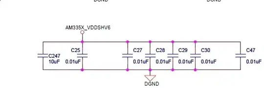

I'm looking at the schematic of the AM3354 EVM and I don't know why I see so many of the same value capacitors used in parallel and typically around the processor or memory.
I understand that different capacitors will have different self resonant frequencies and perhaps that is advantageous for noise filtering but why so many of the same value? Isn't one sufficient?
This question is based around the same value of components not simply combining different value capacitors into one larger capacitance part.
TI AM3354 EVM Base board schematic
Capacitor array

If you count the power pins on the IC, and the supply decoupling caps of the same value, you'll probably find a 1:1 correspondence. This indicates you are expected to place one per power pin, as close as practical to the pin, to minimise the effects of trace inductance.

    +1. That processor has 9 pins/balls connected to VDDSHV6, but they are so close together that it makes it impractical to place a 10nF cap per pin. 6 is the best you can do. – Steve G Jan 13 '17 at 16:31
They are usually just multiple decoupling capacitors on the various pins of a IC that are cumbersome to show in their physical location to each pin on a schematic.
  • Thanks. Yeah that makes sense that they would be in a group on the schematic but at the pins on the PCB layout. – Samee87 Jan 13 '17 at 16:59

Because large caps also mean large internal resistance and large inductance. By putting small caps in parallel, you can still get the same capacitance, at the same time, smaller total ESR compared to a single big cap. Possible duplicate here: Why too many capacitors in parallel for Vdd supply net? Can't we just add all to replace with one big capacitor?

Other answers have covered the one-decoupling-cap-per-power-supply-pin point.
You'll also notice that one of the caps is a 10uF. Typically this would be an electrolytic cap. Electrolytics are good at storing a large amount of charge (they have high capacitance for their physical size) but typically also have a high parasitic impedance which slows down their provision of that stored charge to the device. When dealing with devices drawing significant current and/or at the end of long power supply tracks, it's common to use a small high-speed capacitor in parallel with an electrolytic. The latter handles larger changes in voltage slowly, and the former handles smaller changes in voltage quickly. It's a fairly intuitive principle, and one which in practise works very well.

  • That makes sense. I'll try to employ a similar practice next time a lay out a small board space permitting of course. – Samee87 Jan 13 '17 at 20:24
