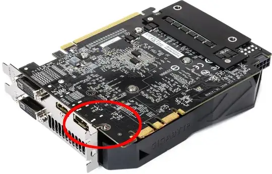

Edit: After measuring with a multimeter, I suspect that brackets (of most graphics cards) are grounded to the graphics card's ground-plane.
I measured 0 ohm between the traces around the motherboard screw holes and the bracket of a (old) 75W graphics card. (All power from the PCIe x16 slot. No power cable needed. So, graphics card's ground-plane == motherboard's ground-plane.) The motherboard was outside the case, on a wooden table.
On some newer graphics card, a screw (which fastens the bracket to the board) is clearly visible on the back side, suggesting direct contact between the bracket and the graphics card's ground. (This construction also counteracts sagging. A little bit.)

  • Usually the holes that the bracket screws into the card through are plated and connect to ground, much like the holes on a motherboard. – Tom Carpenter Jan 07 '17 at 11:41

  • The screws for the DVI connector is what grounds the bracket when unconnected. – winny Jan 07 '17 at 12:09
  • Perhaps it is possible to find one with just DP/HDMI where the bracket is just screwed to the PCB but for EMI and class I product reasons, it's probably an exposed grounded copper area where the bracket in screwed in. What Andy said, measure it. – winny Jan 07 '17 at 16:53

However, it is up to the card designer as to whether the bracket is directly bonded to the card's power supply ground. I would actually expect that there would be some isolation via some combination of resistor/capacitor/diode in order to avoid creating ground loops through the motherboard. But this would still provide some degree of protection from ESD if you handle the card by its bracket when not installed.

In theory, the faceplate of an electronic device with "hot pluggable" cables should not be connected to signal ground directly. The idea behind is that the path of current from any ElectroStatic Discharge (ESD) will go into metal housing (which is normally connected via metal chassis to Earth ground) first, and will not cross board signals. Even if the board ground is made of flooded copper layer and has low impedance, kV-level voltages from ESD can create substantial voltage "bouncing" across the signal ground, exposing signals between internal chips to dangerous overvoltage.
