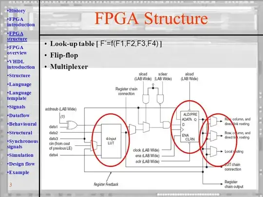

When you look at the structure of an FGPA - it appears to only have slightly more complexity than a 4-bit adder.

    You are wrong @hawkeye. The basic cell of an FPGA usually has one or two flip-flops and that marks a huge difference against a "simple four bit adder" which is a purely combinational circuit. Then you have the routing, which gives you the possibility of making complex logic. A brain is not only the neurons, it is also the interconnections. An FPGA is formed of LUTs, FFs, and routing (and nowadays huge complex hard IPs, like complex processors, transceivers, and Mbits of RAM). – Claudio Avi Chami Jan 06 '17 at 05:29

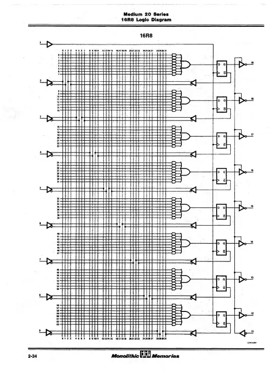

PALs were usually a much simpler structure than FPGAs, generally a comprehensively interconnected network of AND-OR gates, with or without registers on the outputs - you broke the connections you didn't need. Each could typically replace 4-8 TTL SSI or MSI packages, a useful saving in board space, and reduced the number of board design changes required.

The schematic for an entire chip, unprogrammed, looked like this:

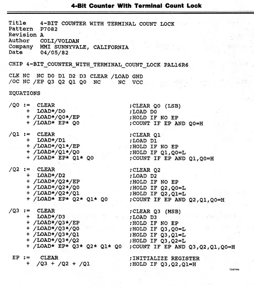

And a program (in this case, one of MMI's own examples, for a 4-bit counter), in PALASM looked like this...
Pretty basic, but easier than marking the fuses you wanted to destroy on the schematic above...
Note the two lines starting "CLK" ... they are names for the pins in order, numbered from 1 to 20. These correspond to the schematic above (which doesn't show pins 10 = GND or 20 = VCC, which are predetermined). Comparing this with the schematic you'll see that CLK and /OC are also predetermined, and all the other input pins are on the left, outputs (registered) on the right.
Also note that this design is for a 16R6 but it'll fit a 16R8 because pins 12 and 19 (which are unregistered in the 16R6) are unused - i.e. NC - in this design.
In practice you'd probably use an off-the-shelf counter like the 74163 instead, unless it was Saturday and Stores was closed, or someone else had goofed the polarity of the Load input.

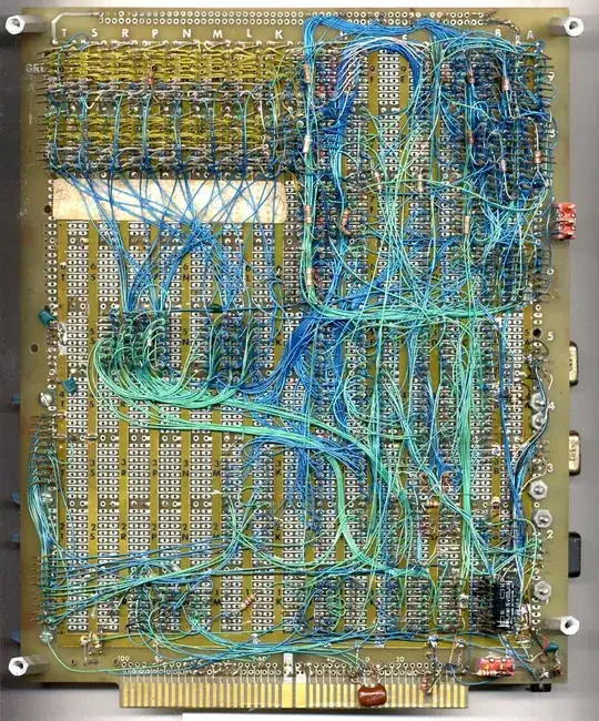

In that era, nobody would have gone to the trouble and expense of building electronically field re-configurable logic systems. What they built instead were mechanically reconfigurable systems using wire-wrap. It looks like this (from this page):
Mac wirewrap
Obviously that's a bit slower to work with than a modern FPGA system, but given the tooling of the time and lack of existing electronics design software, it was normal for people to design on paper and transfer directly to a physical prototype.
It wasn't just for prototyping, small to medium volume manufacturing was done this way. See MIT Lisp Machine:
It was possible to field-modify these by cutting or unwrapping wires then adding new ones. This was routinely done for bugfixes or customer service "patches".
