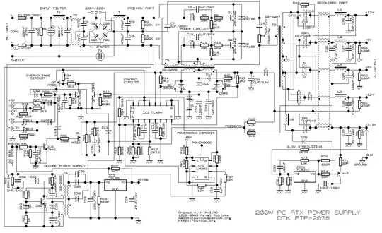

I am slowly learning how to analyze circuits but I am wondering if my goals are unrealistic. My main reason is to help me repair circuits boards that I come across in my line of work. (I repair coin-op equipment) Sometimes the most info I can find are schematics if I am lucky and they are usually lacking in details when it comes to voltages and scope readings. I would like to be able to figure the voltages at any node and to understand what components could be bad if I get a lower voltage, zero voltage, higher voltage or supply voltage on any particular node. Mostly DC voltages but AC signals would also be useful. Most circuit analysis books teach from the point of view of engineering but my goal isn't so grand, I just want to do this for repair work. Would this make enough of a difference to allow for short cuts and general rules that can allow you to work through a circuit and figure these voltages?.
Can people look at schematics, like the ones I have attached, and figure these voltages without a computer, or lots of time with a paper, pencil and calculator? Can you mentally work out the voltages in a quick way? I don't need exact, just close enough to see there is a problem. If this can be done are there ways to learn this method? It also seems most books break down parts of these schematics but I don't see too many that work their way through a complete schematic showing the thought process involved. Is there a book or site that does this type of thing!

    Yes, I could go through a schematic like that and indicate approximate voltages you'd expect. As could Olin, Wouter, Oli (as I know something of their past history) and numerous others here. It's largely a matter of logic based on device parameters and drummed in by long experience. There are always traps and unexpected tricks played by circuit designers but most of it just makes sense by following "the laws" of physics and knowing what data sheets say. That diagram is very low quality. If you post a much better version I could point out a few areas where you can work out such things and how. – Russell McMahon Mar 09 '12 at 01:02

  • It is hard find a schematic that includes examples of the many different circuits I come across but it mostly the standard kind of circuits in embedded controllers along with power supplies and CRT monitors, LCD monitors and all the stuff you can imagine in equipment that takes coins and bills to operate.
    If this schematic came out better, can you give me an example on how it would work to come up with voltages as you go through the schematic or can you point me to some kind of reference that would help me learn that particular skill? If there are ways of working this out quickly,Thanks,Russ

  • I was staring at this schematic for a while trying to understand why it was "very low quality", until I looked in the revision history and saw that the current schematic replaced poor scans and images too small to make out. – darron Mar 09 '12 at 16:47

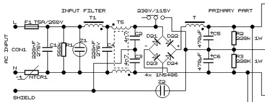

As a example, here is a quick analisys of the top left block of your schematic:
You should be able to see right away this is the power input block. If nothing else, it says "AC Input" at the left. There are basically two common AC input power blocks. The old ones run the AC input into a big iron transformer that runs at the power line frequency. That will have a secondary, often with multiple taps, to produce the lower voltages which are then rectified and filtered to make the unregulated DC supplies. The more modern kind full wave rectifies the AC line. This DC is then chopped at high frequency and run thru a much smaller transformer to make the AC for the roughly regulated DC supplies.
It should be immediately obvious this AC input is of the second kind. The four diodes in the middle are arranged in a classic full wave bridge configuration. See the diamond shape made by 4 diodes a little right of center. That's a pattern your eyes will pickup quickly with a little experience. If you've never seen one before, think about it a little and see how it works. Once you've done that, you should be able to quickly recognize a full wave bridge next time you see one. The full wave bridge also nicely divides the circuit into the AC part on the left and the DC part on the right. Again, T5 should pop out to you as a classic balun filter, which is something you should expect to see in this kind of AC input block. The rest of the crap left of the balun you can just assume is for filtering and spike suppression with little reason to analyze it in detail.
There is one cute trick here worth noting and filing away for future reference. Note the 230V/115V switch at the top. Analyze the circuit with the switch in the 230V position first. In that mode it is a basic full wave bridge that will charge up the combination of C5 and C6 to the magnitude of the peak voltage difference bewteen the L and N inputs. So far so good. Now mentally throw the switch to the 115V position and think about what is happening very carefully. You should study this in detail yourself, but very breifly there is now a charge pump going on so that plus and minus the peak magnitude will appear accross C5 and C6. This will result in roughly the same DC voltage with 115V input as with 230V input and the switch in the other position.
This method is sortof a hybrid between old and new. More modern AC power input circuits just full wave rectify what comes in and deal with the resulting wider range of DC by adjusting how that is chopped up to drive the internal high frequency power transformer. Most recently designed power supplies now feature "universal power input", generally from 90-260 Volts at 50-60 Hz, which covers wall power accross the globe.
So you should have roughly 325 V total, with about half of that (about 160 V) accross each of C5 and C6.
I'm not going to go thru the whole circuit, but this is how you proceed. Go block by block, keeping in mind the overall problem the designer was trying to address, and that the designer was only human and the circuit you see is probably "good enough" but not necessarily a examplar of excellent design.
