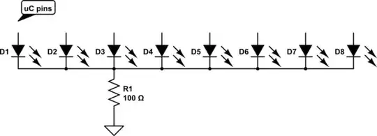

If I read this right, the schematic would look more or less like this.
schematic
This works as long only one LED is powered at the same time. You could just multiplex them.
If you want to power severals at the same time, they will not shine with the same brightness depending on the number of lit LEDs.
You might want to check This question
  • You could remove that resistor and ground directly, but then you would need 8 resistors for each LED on top. – Nazar Dec 30 '16 at 13:37
  • Yes, 8 resistors for each LED on top is the correct way to build this. Using a single resistor on GND is much simpler and safe with the mentioned drawback that the brightness depends on the number of segments being on. – Goswin von Brederlow Jan 23 '18 at 11:59
