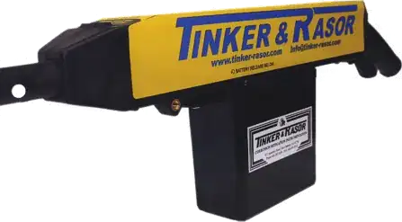

We are measuring pulse DC voltage up to 35K on Tinker & Rasor high voltage holiday meters for checking the thickness of coating applications.
I would like to check our units each time they go out between calibration cycles. We need a peak reading volt meter but have a crest reading volt meter. how do they differ and will the crest reading volt meter give me a correct reading?
Thanks Gene
  • The Tinker & Rasor Model APS High Voltage Holiday Detector supplies 800V to 35 kV in one instrument with two ranges: high range of 3,500V to 35,000V, an low range of 800V to 8,000V. Typical applications are checking coatings on pipelines and other coated structures, tanks, concrete, sewers, and manholes.
Also here.
