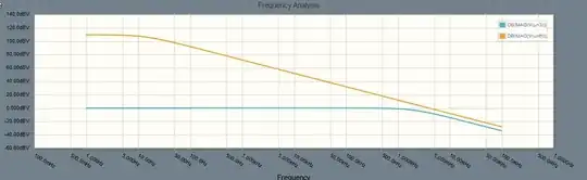

Negative feedback decreases the gain at low frequencies but does not affect it much at high frequencies. The frequency range over which the gain is almost constant is increased. Compare the -3dB points of the two amplifier circuits below:
schematic
