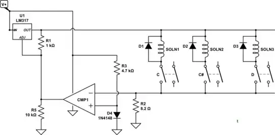

My initial thoughts were that if a current sensing resistor, R2, can be added into the switch ground return as shown then you may be able to trigger a comparitor, CMP1. D4 provides a 0.7 V reference and R2 is chosen so that the voltage across it will exceed 0.7 V when two or more solenoids are on.
Since we are now monitoring the current we can change the LM317 configuration to constant voltage rather than constant current. The open collector of the comparitor can then shunt the LM317 voltage divider to drop the voltage to a couple of volts and unlatch the additional solenoids.
A pulse extender or monostable is required on the output of CMP1 (but not shown) to hold the LM317 low until the unpressed solenoids all release. Without this the voltage will probably oscillate.
Figure 2. If low-side current sensing is a problem the LT2940 power and current monitor might provide a solution.
The configuration shown in Figure 2 is monitoring power and multiplies the current and voltage. You don't require that and I guess that the V+ and V- inputs should be held at a constant voltage rather than monitor the load voltage.
Figure 3. Block schematic.
The LT2940 has two complimentary comparitor outputs which may save an inverter stage in your application.

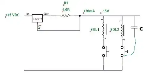

Add a capacitance such that the parallel LC creates a resonance. If there is resonance, current will flow in that direction for a good amount of time.
That blue line is a movable wire. I'm not sure if this will work but it might..
  • It's good that the wire is moveable. I have not fully processed this idea, but where it is now would just be across the entire parallel string of 25 rather mismatched coils. Perhaps directly across each solenoid, but then finding the right cap(s) may be quite troublesome. Anyway, we want to steal current away from only one solenoid that is held by its own holding contact. In fact, the Hammond design literally drops voltage to zero for a fraction of a second. – ITPhoenix Dec 17 '16 at 19:41
  • @ITPhoenix When you press that pedal, right before touchdown, the capacitor has 0 charge on it. But after the touchdown, the capacitor is effectively short circuiting its "+" and "-" sides. This will cause to draw a huge amount of current for a couple ms and will kill all solenoids currents for some time. The bigger the capacitor, the better. Also, undear steady conditions, the capacitors won't hold charge because there will be little V difference on your coils (DC current). So when you touch down a capacitor, other caps won't be feeding it, it will be drawing current from the coils. –  Dec 17 '16 at 19:46

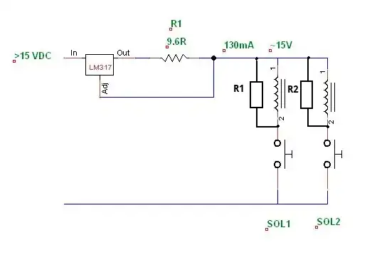

Try adding a resistor in parallel with each coil to bleed off some of the current that is holding the solenoid on, about 20-30ma should suffice (470 - 750R). This would reduce the half current to 25mA and leave the normal (full current) at 100mA, more than enough to hold.
JIm Dearden
  • 19,036
  • 30
  • 40
  • @Jlm Dearden. This looks promising besides being cheap and easy. The resistances on all the solenoids are within 5% and they all work independently. In fact some of them will drop as desired, but a few of them won't release. I could use a pot to determine the precise resistance for each solenoid just before dropout. One of them that refuses to release seems like a magnetic accelerator gun. Same resistance, same current. – ITPhoenix Dec 17 '16 at 19:34
  • The actual resistances of the solenoids won't tell you which ones will hold and which will dropout. Its down to stiction and magnetic force. I don't think you need to be too precise with the value of the fixed resistor - it just needs to be big enough to keep the solenoid on and small enough to let it drop out. – JIm Dearden Dec 17 '16 at 20:38
  • @Jlm Dearden. Thanks. I meant deriving the resistor value for each solenoid, which I assumed would be necessary. I have to make sure the system is reliable, so I will experiment some. – ITPhoenix Dec 18 '16 at 00:03
  • @Jlm Dearden. The original CC power supply was rebuilt and adjusted. The same problem occurs with sols. 1 and 3, same as before, except 7 offers no problem now. The resistor idea was tried with a 1k 10-turn pot. The problem sols. will drop but refuse to latch, even after several fine adjustments. It appears that the 2 problem sols. have above average magnetic force, since there are no mechanical problems. So it's back to the custom CC power supply with the addition of an adjustable, one-shot, full output dropout. If anyone has any quick solutions, kindly posit at your convenience. – ITPhoenix Jan 04 '17 at 16:14
