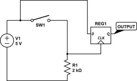

I'll be using a momentary push button, SW1 as shown in the figure. With that, I also decided to make a D flip-flop act like a latch by connecting the switch to the clock.
My question is if my pull-down resistor value is correct. I'll be using 74LS DIP IC gate specifically HD74LS74A. According to the data sheet, the Vil is about 0.8V while the Iil for the clock input is 0.4mA. Based on my readings in forums, I divided the two resulting to 2KΩ.
Should I aim for 2KΩ or should I use a higher or lower value for the pull-down. Sorry I'm not very familiar with this topic.

You are making a small mistake.
Your V(il) reading is a maximum, so anything below it is okay, but above might not be seen as a low input.
You can also see that the I(il) input current is negative, which means current comes out.
So your pull-down resistor will need to be lower to guarantee operation.
However, you can also put the switch in the bottom part, since a switch has a very low resistance when pushed, and then put a 1k to 10k pull-up resistor. Because you can see that the minimum input high voltage is only 2V and that the current it draws at a high input is ten times as small.

  • Sorry, this kinda confused me. So technically, my pull down resistor would work if it is less than 2k Ohms;, say 1500 k Ohms;. However, pull-up resistors make the circuit normally closed because as the button is pushed, current stops flowing; am I right? – Orlando Lewis Dec 13 '16 at 23:16
  • And also, what do you mean by 'sunk' here? – Orlando Lewis Dec 13 '16 at 23:24
  • @OrlandoLewis Yes, with a lower resistor it will probably work. It may even work with 2k, since the datasheet gives limits, but 2k is considered risky (may work some times, may not others). Generally in digital systems you want big margins and low currents. A 1k (the number I'd pick, or lower) would drain 5mA when the button is pushed. Pros don't like that. If the button is to ground, you will make the signal low of course when you push, but when you release it will go high, so with a pulse button.... "sunk" is an English word: http://www.dictionary.com/browse/sunk – Asmyldof Dec 14 '16 at 07:15

Your 2k Ohm value is only correct to set an absolute maximum V(IL) value, you should make it less than 2k to ensure you generate a lower voltage than the
V(IL) spec for the device.

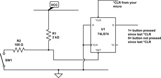

However I'd suggest you should not implement the switch this way. Your switch may be some distance (inches or more perhaps) from your logic PCB, and it is poor policy to run a supply voltage (+5 VCC in this case) to any panel mounted switches. The reason is that any short to Gnd will potentially short out your supply voltage. This might not damage your logic or power supply, but it will cause a reset or malfunction of your logic.
I'd suggest the following if you want to use an LS7474 device:
schematic
Notice in the schematic above the *SET input would be pulled low by the switch, and would actually set the 'Q' high (if it was not already so) immediately. The circuit is immune to switch bounce, and the Q remains set until cleared by your other logic or microprocessor pulling the *CLR low. Notice from the datasheet that if both *CLR and *SET are pulled low at the same time, the Q output remains high until either *CLR or *SET go back to one, where the state of Q is defined by the last one to go high.
Your circuit as shown shows no way to set 'Q' to an initial state, or to clear 'Q' after you have read/used the value. This one above uses the *CLR to initialize or reset Q.
The 2k used as a pullup is a rather arbitrary selection. It's best to have some current flow in the switch (it's called a wetting current) and in this case you will have 2.5 mA from the 2k and 0.8 mA from the *SET for a total of 3.3 mA in the switch when depressed.

  • I find this complicated. I'm not using any PCB. I also have a different momentary push button for the clear and I was thinking to connect the preset to my +5 V side – Orlando Lewis Dec 14 '16 at 00:58
  • @Orlando. Then the circuit still suits......you simply use another push button to the *CLR side of the LS7474. How is it more complicated than using the CLK pin? – Jack Creasey Dec 14 '16 at 01:14
