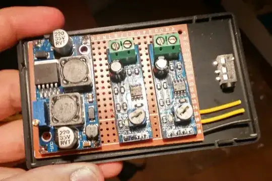

instead of using a radio, I want to install a Raspberry Pi 3 with my own features in the 2Din Slot, so I have to make my own circuit to play audio. I tried with the following modules based in LM386 pic:
It doesn't work bad at all, but neither good enough, the max volume is not as high as I would like it to be, the sound is not clear, starts to crackle if I increase it, and the bass level is so bad.

LM386 power amplifiers are just too puny to overcome high ambient noise level inside a car. The cracking you describe could have two causes: power amplifier clipping, or speaker overload. Considering the weak driver (LM386), amplifier clipping likely causes distortion, and limits power output.

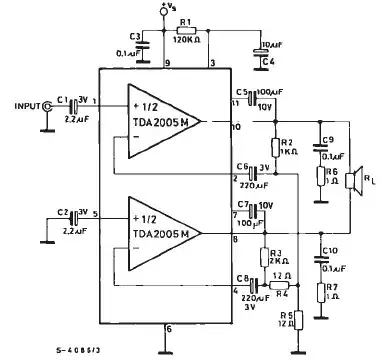

You certainly need a more powerful amplifier. Some considerations for you before choosing a solution:
What net speaker resistance will the amplifier drive? (8 ohms? 4 ohms?...)
From what DC voltage source will the amplifier be powered? (12.6v? custom?)
Your open-ended sound-level spec ("not as high as I would like it to be", "high bass is one of my priorities") is too subjective. It is possible that a bridged amplifier powered from the 12.6v car source will satisfy, if it drives a 4-ohm speaker load.
Bridged one-channel amplifier At maximum volume (where clipping begins), conversation with an adjacent companion will be very difficult. If you need more volume, a higher DC supply voltage than 12.6v would be required. I am assuming old-school Class AB linear amplifier technology, similar to the low-power LM386.

  • Hm, I'm looking for that TDA2005M, I got some doubts... do I need one IC per channel (L and R), right? so I connect R output with both rear and front R in series? At least thats how I did with the module shown in my picture. Well, by now I will look for the datasheet. – Mc Kernel Dec 09 '16 at 15:56
  • @McKernel , Yes, one IC for LEFT, another IC for RIGHT. I would connect Rfront & Rrear in parallel, not series. (Lfront parallel Lrear). Be careful to phase properly for good bass. Consider too, dim suggestion of Class D bridged amps for their better efficiency, less heatsinking required. You'll need considerable heatsink for those two TDA2005's. – glen_geek Dec 09 '16 at 16:15
