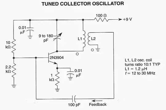

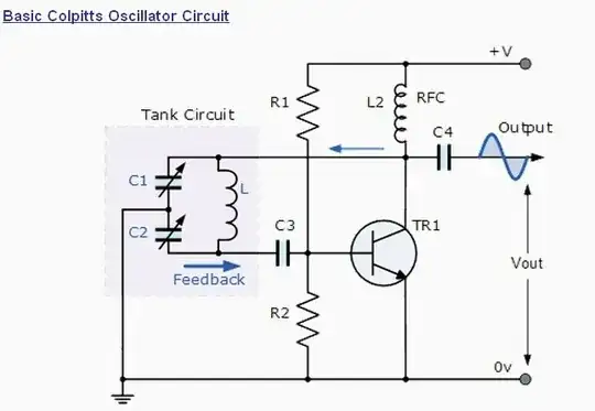

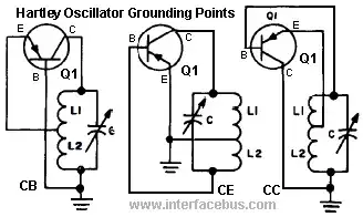

This is essentially what an oscillator using a "tuned tank" inductor-capacitor does.
Google Colpits, Hartley, LC resonant, Pierce, ... etc.
Can be done with as little as a single active device - eg a bipolar transistor or a MOSFET or a thermionic valve or ... .
Circuits below can be implemented "in an IC" if desired, but, just using a transistor will often be enough.
Tuned tank oscillator - many images, all with links

Hartley Oscillators
Basic Hartley oscillators - varying grounding point.
NB note that this is what AC sees - DC needs a blocking component to stop DC shorting.

    On the so called in this case "Tuned Collector Oscilator" the tank is L1 and the 9 to 180 pF cap. If you dont want a second winding use another circuit. | In the basic Colpitts the tank circuit is the part in grey labelled tank circuit. If you don't want a tapped C use another circuit.| In the Hartley it's the only inductor plus the capacitor across it. If you don't want a tapped inductor use another circuit. | If you don't want any of these work out how get feedback from an output with a pure untapped tank. Doable. – Russell McMahon Mar 01 '12 at 02:54
