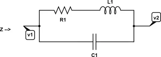

So, I was intrigued by how I was able to determine Q by taking negative ratio of resistance to reactance. I found the reason, and thought it would be good to share it with those of you interested.
I went back to the definition of Q: Q= Reactive Energy (or Power)/ Active Power (energy) evaluated at the natural frequency (undamped) (btw, resonant frequency approaches the natural frequency as the losses, R's, in the circuit approach 0. Using a simplified circuit example:
schematic
simulate this circuit – Schematic created using CircuitLab [ratio_reactive_to-resistive_power
